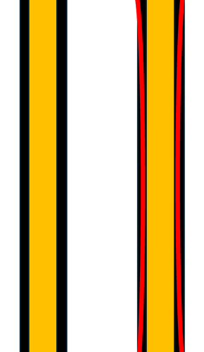

1. Does the door wobble side to side at the bottom? If so, there is no guide or guides on the bottom of the door frame which will need to be fitted. There are two types. 1. The door will either have a slotted groove running along the bottom that runs in a plastic guide screwed to the door frame. 2. This is the easier to install even if there is a groove, which are guides that screw to each bottom side of the door frame. The door runs along theses guides. They just need setting about 2mm off the door. Reefer to photo below.
2. The door opening is bowing inwards on one or both sides. In my experience this is extremely difficult to repair. It doesn't sound like sanding the door will help because you will add this thickness back on when repainting it. Best bet is to remove the door and remove material from the inside edge of the door opening timbers by around 5mm either side. This will allow plenty of clearance for the extra couple of mm added back on to the repainted door.
