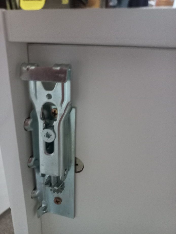

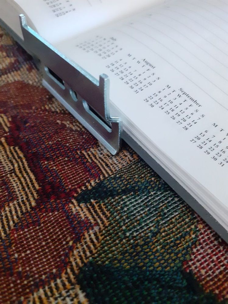

Before we start installing this unit is there a YouTube or other video that we could follow? The brackets provided and the cabinet brackets look a little incompatible (width). A video would clarify. Thank You. ps could not locate any on the Mondella website.provided guideprovided guidebracket on rear of unitbracket on rear of unitbracket 1 of 2bracket 1 of 2

You might like to read through this previous discussion: How to install a Mondella shaving cabinet. Installation is quite straightforward, though it's not a bracket mechanism that many people would be familiar with. Essentially, you fit the bracket to the wall, and the side that is mounted to the wall is closest to your diary. This provides a section that stands off the wall, allowing the hooks on the back of the cabinet to grab onto it.
Unfortunately, there is a video of the installation I could point you to, but once you've installed the bracket on the wall, if you run into any difficulties, we could certainly answer any questions you have.
