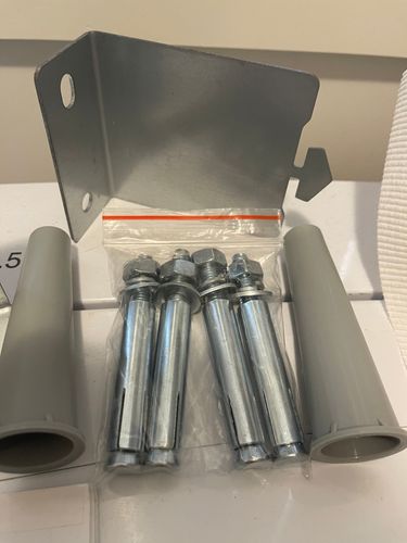

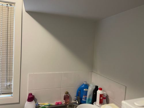

Here are pictures of laundry above sink where I would like to mount dryer, the bracket kit( not sure what plastic cones are for) the dryer and the 2x4 piece of wood to attach to studs and then attach dryer

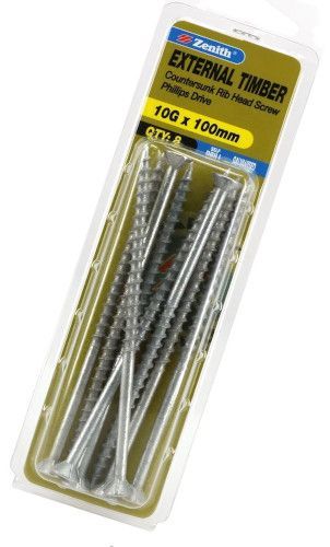

Since you are penetrating 50mm of bracing timber and 10mm of plasterboard, I suggest using a pair of 10G x 100mm Countersunk Timber Screws at each stud position. They will self drill into the stud, and self countersink into the timber brace. The screws provide 40mm of bite into each stud.

It's great that you've received fantastic advice from @Walzz. It's possible that the cones are for the back of your dryer to prevent it from tilting forward. However, have a look at your installation manual and see if your machine came with an extra two brackets for the bottom. I recommend giving the store you purchased your dryer from a call and inquire how the cones are installed. I suggest investigating the back of your dryer and seeing if there are slide-in slots for the cones.

Those cones are for the bottom of the dryer. They hold it out from the wall to compensate for the depth of the timber bridge.

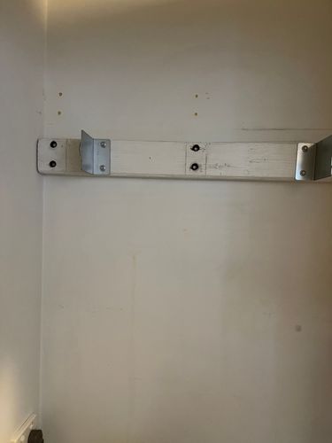

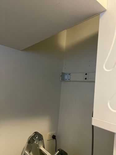

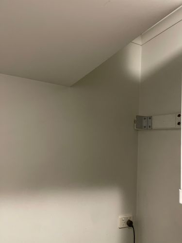

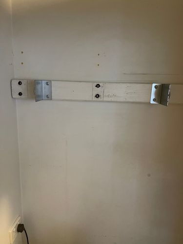

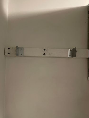

Well I’ve got the support beam up and brackets attached. I did make one mistake and not allow space for the dryer to be lifted onto the brackets with the over hang on the ceiling, but I’ve patched the holes and I’ll give it a paint and no one will ever know.
 now all I need is a bit of muscle to help with the lift. Not too bad a job for my first effort.
bect73
Building a Reputation
Re: How to mount dryer with no studs?
@EricL @MitchellMc
Thank you for all the information and guidance you have given me. I think I have done a pretty good job so far. Support beam is up,  (for the second time) and brackets attached, just require some muscle now to help me hang it. I did forget to leave enough space to lift the dryer onto brackets due to low ceiling point, but I’ve filled holes and painted them. I will post a pic once the dryer is hung, until then here is my progress
