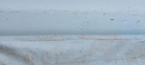

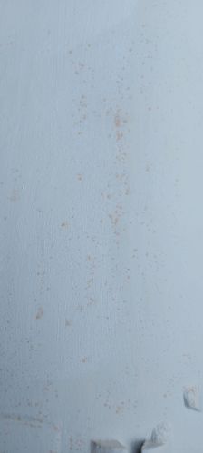

Thank you Eric. Initially, any loose previous paint was removed & sanded back to remove rust. It was then painted with the paint pictured (which was recommended) but the rust appears to have bled back through again.
Thank you so much for posting photos of the bath. The little bits of rust spotting are from the rust residue left on the surface of the tub when you were sanding it clean. It got trapped in the paint and is now slowly rusting through. How old is the paint on the bath? This will give us a rough idea of how long it takes the rust to travel through and stain the surface of the paint.
In order to accomplish an in-depth repair, it will be necessary to sand off all the paint and prep the steel properly. But if you are after a quick cosmetic fix, I propose sanding all the rust stains as far as you can until they are all gone and then recoat the bath with the epoxy enamel. Please make sure to wash the bath so that all the sanding dust has been removed before you start painting.

The photos you posted are sufficient. If it has only been a week since it was painted, it's likely that rust got left behind on the surface.
