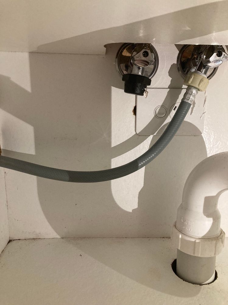

I actually had the same situation and went to my local Bunnings which is one of the larger ones and was told that they did not carry the Bostik plumber's putty and that they hadn't carried it for at least 10 years. Wondering if there is an alternative?
I checked the hose for cracks and couldn't see any. I did buy the washer set referenced in another post but the hose still leaked. In the end I just replaced the hose and the leak stopped.

Nice to hear from you. My hose didn't have a hose clamp, it was the one with the plastic ribbed connection. I had read on one of the other posts that some plumber's putty or changing the washer inside might help hence my post. It's fixed but the washer didn't help, nor did incremental tightening and checking.
Re: How to prevent leaks from washing machine drain hose connection?
Could you show us a picture of it, @tigerzen? Typically, to get a seal on a trap spigot barb, you need a rubber end fitting on the ribbed hose. The ribbed hose itself won't seal particularly well or at all on a barbed spigot, due to the ribs. Any hose definitely needs a hose clamp to achieve a secure seal.
It sounds like you should swap the hose on the machine out for one like the Kinetic 2m Grey PVC Washing Machine And Dishwasher Outlet Drain Hose with the required rubber fitting.

Here is a picture of the hose before I swapped it over, someone had tried teflon which wasn't working. It seems fine now that I have put a new hose on.
Oh, OK @tigerzen.
This discussion is about the outlet waste pipe, whereas yours is the inlet pipe. That changes things. I also missed the sentence "In the end I just replaced the hose and the leak stopped," and now realise you were offering some helpful advice and weren't after assistance.
It's great to hear you resolved the leak, and sometimes replacing the hose is the best course of action.
