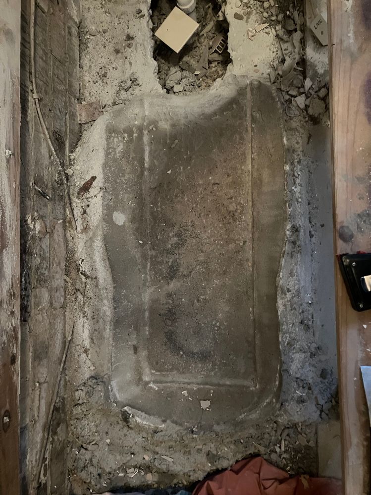

Hello friends,
I removed the old standard size spa bath tub in my bathroom with the plan to replace it with a regular bath. I now need to remove the mortar bed it was sitting on to install the new bath. I am wondering what my options are for removing it other than taking to it with a sledge hammer. I am reluctant to use a sledge hammer because I don't want to accidentally damage the slab underneath. What other options do I have? I have read I can use a reciprocating saw with a diamond blade? Is there an option to leave it there and bond a fresh layer of mortar to support the new bath? Have included photo to show size and thickness. And yes that is an electrical wire set in the mortar.

The smallest and lightest electric breaker you can find is the ideal tool for this job. Buninngs have the Ozito 900W 3.5J Rotary Hammer Drill Kit for about $90, it will have a point and a chisel attachement with it too. Go carefully and slowly and Use the hammer setting only (not the rotary drill setting). You'll need a dust pan and broom to remove rubble, a bucket to carry the rubbish outside. Clean it out regularly so you can clearly see the leading edge of the work and help you avoid damaging the surrounds. Something comfortable to kneel on while you work and ear and eye protection is a must for a job like that. Have fun!

You could also try breaking it up using a drill (corded or cordless) set to hammer with masonry bit.
Then pick at the holes with something like the Trojan Fibreglass Handle Pick Hoe (0101389) and also tap with the hoe end.

It's fantastic that you've received excellent advice from @Tim_Engineer and @AlanM52. I totally agree with the suggestion of keeping it clean so that you can keep an eye on the leading edge of the mortar bed. This will prevent you from accidentally digging into the slab underneath. It might be possible to just trim the surface of the old mortar, but it will require you to do a test fitting to make sure that the new bath will fit. As to the new mortar bed you just need to make sure that you have enough space for it when you push the new bath in.

Ive never had to replace a bathtub tho expect I will be doing the same when I redo my bathroom sometime :smile: I have removed mortar from a varity of bricks, rocks and generally it has sheered off with a bit of force. Mortar has no re-enforcing in it so I would actually go old school with a pound hammer and a cold chisel. I would work from the edge of the mortar (where it meets the slab) and then inwards. Have the cold chisel at a 30 deg angle and use a pound hammer (you can get them with a rubber cowl around the top to help protect the hand)
Once the mortar cracks it should be easy to remove.

I would be tackling it as @Tim_Engineer has suggested with a Pneumatic hammer with a both a narrow and wide angled chisel. As good as that Ozito model is that he suggested, its going to be very slow going as it doesn't have a heavy enough impact/Joel rating. I would recommend hiring a small to medium hammer specific (non-drilling). From several first hand-experiences it's well worth going down this track. Even a compact model like this will still be relatively heavy. The trick is to not apply too much downward pressure, just let the tool do the work. You just concentrate on steering and adjusting the angle. It won't take long to get the hand of it.

Thanks. I have received lots of great advice. Can I clarify, are you saying there is no need to remove all of the mortar if the new bath fits with enough space for a fresh mortar bed? Does this mean so long as the new bath is supported properly with fresh mortar it is ok to sit the new mortar on top of old mortar? I will wear an N95,  hearing protection, gloves and goggles.

Thanks Dave. I had to google what a pound hammer is, but was pleased to realise that I already own one :smile: I will try this first and see how I go. Good point about the lack of reinforcement.
