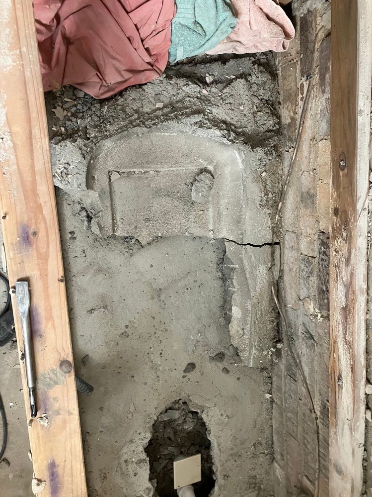

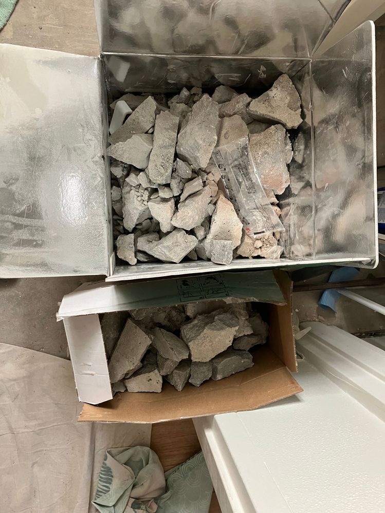

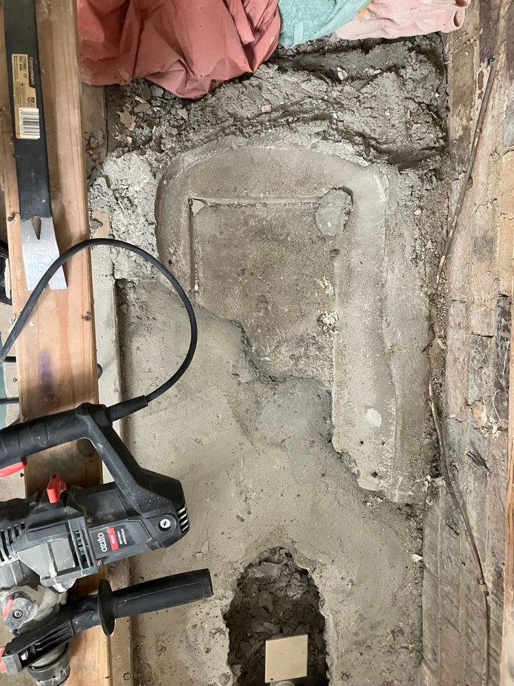

The mortar bed has been successfully and relatively easily removed. I ended up using the Ozito 900w hammer drill as I already had this tool. I used a combination of the chisel and pointy (don't know what that's called) attachments and just used which one made sense. The pointy one was good for shearing off pieces close to the leading edge and the chisel for getting underneath. The concrete naturally separated from the underlying slab as it broke so avoiding damage was easy. It was good to have two drill bits because inevitably I would occasionally get them stuck and need to use one to free the other.  I have attached some photos. When I got to the point in the second photo that entire block lifted from the slab as one piece. I can't remove it though until I get an electrician to deal with the small matter of the electrical cord that is embedded in it. @Nailbag @EricL @AlanM52 @Dave-1 @Tim_Engineer Half wayHalf wayIMG_1768.jpegIMG_1769.jpeg
