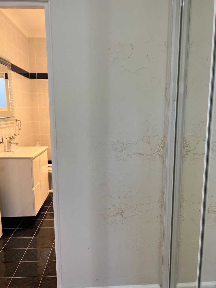

I am needing assistance with this wall.
Looking to scrape and repaint this wall, however unsure which products to use to waterproof and scrap off the existing paint.
The damage is from a water leak in the shower which i have gotten it fixed now. Just need to fix the wall on the outside.
Damaged wall

I'd suggest you sand back the paint until the area is smooth with 180-grit sandpaper. If there is any damage to the surface, you might need to do a thin coat of Spakfilla and sand it smooth once it's dried. You'll then be able to prime the area with Dulux 1Step, and once dry, apply your topcoat bathroom paint.
Here's a handy guide: How to prepare a wall for painting.
Remember your PPE, including safety glasses, face mask and gloves.
