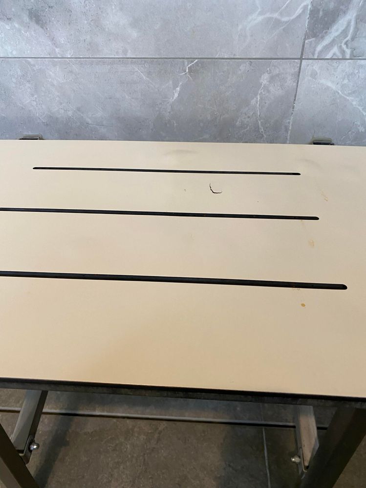

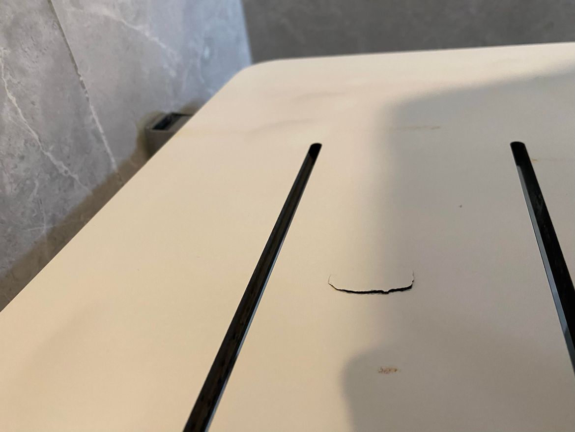

I have a small shower bench with a new ding / dent, and I'm interested in any tips that might help me repair it myself.  At the outset I should say - I have limited tools and experience, but I'd like to have a go if I'm able.
Sadly, I can't find anything like a product information sheet, but my untrained eye is guessing that this is laminate.  The product is a fold down shower bench (https://www.lencare.com.au/shop/bathroom-series/shower-seat-plus-drain-slots/) Size of he dent is 30 x 10mm.  It's a brand new problem, not yet exposed to water from a shower.  Looks like something has been dropped on it.
I have some SikaSeal Kitchen & Bathroom wet area silicone (I've been putting off learning about that for the unsealed kitchen sink and splashbacks that came with the house).  Some beginner's research I've just done makes me think that epoxy may be a better choice, possibly?

I believe the damage is repairable, I propose using Gorilla 59ml Glue Bottle. I suggest gently lifting the laminate and applying some glue on the bottom of the laminate spot. Please make sure that it is totally dry before applying the glue. Once the glue is applied press the laminate back onto the surface and keep it pressed for about 30 seconds. Allow the adhesive to cure to full strength. Once the glue has fully cured, I recommend applying a small bead of glue on the surface where the laminate has split. This will act like a seal to the split in the laminate surface. Allow that bead to cure before using the seat.

To me, the chipped laminate is only one side? I would be loath to lift it much further for glue.
Just a thought - but the glue 'reach' will be better with a syringe and drawing up needle to inject deeper into the cavity.

Laminate is indeed one side.  Just bought the glue.  Will use a syringe.  And I reckon a ratchet strap might act as a clamp while it cures

Reading the Gorilla Glue instructions - they say that one surface should be dampened.  Am I right to go 1) make sure everything is 100% dry to start then 2) try to dampen just one surface?  The gap is quite small (and currently protected with plastic / gaffer!) but I could probably use a damp rag and carefully work it in there by keeping it taught "like dental floss."  I'm not sure whether that explains my thinking properly.
Re: Laminate shower bench repair (ding / dent)
Hi @LynneWasTaken,
The Gorilla glue is a moisture-activated polyurethane adhesive, which means moisture is what triggers its chemical reaction and makes it expand, foam slightly, and cure to full strength. I wouldn't worry too much about how you apply the water, just that a small amount gets in there.
You could use a spray bottle to put a very small amount of water in the crack. One pull of the trigger should suffice. The water will find its way into the gap.
