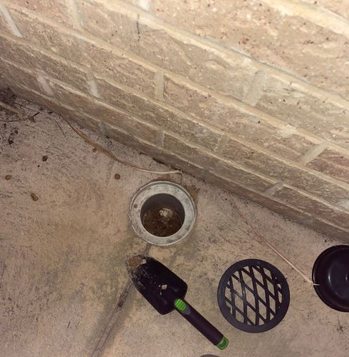

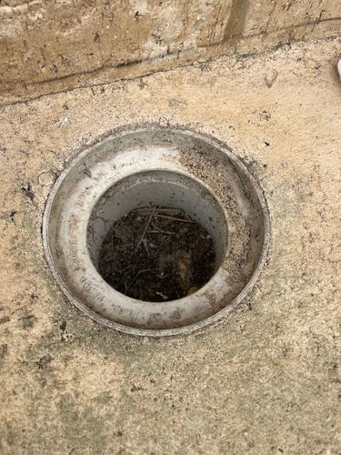

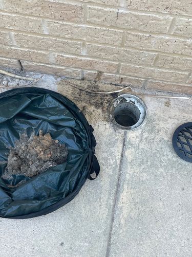

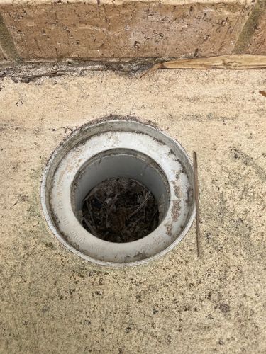

Thanks for the reply Mitchell, so I have a few different types of drain:
These, that sit flush to the floor, and appear to of been filled with debris. Unsure if these are ORGs? They also have pipes leading from the floor trap in the bathrooms, which have been covered. Like so:

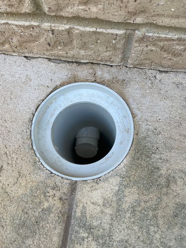

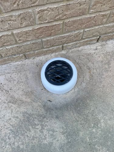

Then I also have these which I’m assuming are definitely ORGs, with standing water in (They have not been filled with sand/debris)
Hi @Firsthomediyer,
ORGs are supposed to be clear so they can safely relieve overflow and prevent sewage backing up into the house.
There’s no real benefit to filling them with sand — it’s likely someone did it to try and block smells temporarily, or just didn’t know what they were doing. They do connect to the main sewer line, so keeping them clear is important.
I'd recommend clearing them out properly and giving the drainage system a good flush. If you’re still getting strong smells after that, it might be worth getting a plumber to check for any deeper blockages or broken seals.
Thanks Mitchell, do you think both are ORGs? The drain that sits flush to the ground too?
Hello @Firsthomediyer
Yes, I suspect that both of them are ORG's. I agree with Mitchell's recommendation of getting a plumber to inspect and unblock the ORG's this might also free up the smell from your bathroom.
