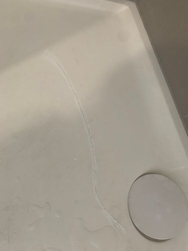

 hello community members, my daughter dropped accidentally shampoo bottle and we found a crack, we went to Bunnings and they suggested some products to apply on it. It’s sealed but before leaving rental I wanted this floor to be look same hence wanted to paint . Kindly suggest a product, not sure it’s a ceramic or resin

Hello @afshan06
Welcome to the Bunnings Workshop community. It's sensational to have you join us.
Generally speaking, a steel shower tray would probably develop a dent and not break under the weight of a dropped shampoo bottle. An acrylic shower tray however can only withstand so much pressure that it will split if enough force is applied to it. Due to the flexible nature of an acrylic shower base none of the paint products will work on its surface. If you wish to have it renewed, I propose engaging the services of a professional shower base restorer. They will have the knowledge and skill to restore your acrylic shower base.
Re: Painting a shower base
Thanks Eric, we believe that so that she has dropped the steel shower caddy, I am not sure the plumber charges . I will looki into at and get the quotes.
