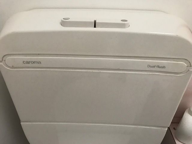

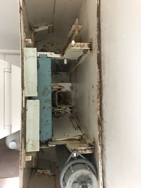

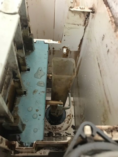

I have a couple of toilets with Caroma Dual Flush cisterns in my house that would be 35-37 years old.  One of the toilets is leaking water from the cistern into the toilet bowl, not a lot but a constant trickle.  I understand that the cistern seat washer is likely to need replacing and have bought a Caroma washer kit to do so.  I have turned the water to the toilet off, removed the lid of the cistern and flushed the toilet to empty the cistern.  BUT I am having difficulty working out how to remove the flushing mechanism to get access to the washer to replace it.  Have checked online videos but the mechanisms all seem to be a bit simpler than the one in my toilets.  Can any of the experts out there give me some tips re how to remove the flushing mechanism?  Thanks.Help!! How do I remove the flushing mechanismHelp!! How do I remove the flushing mechanismOverhead view with cistern lid removedOverhead view with cistern lid removedCaroma Dual flushCaroma Dual flush

The flushing unit is being held in by a locking clasp connected to the filling valve. If you look at the labelled picture below, I've indicated which part needs to be removed in order for you to slide the flushing unit out. Please note that there may be a secondary plastic pin that's holding the unit in place.

I know this is an old post. However, just in case anyone come across it I thought I'd add that the first thing that needs to be removed after you remove the cistern lid is the plastice strip which has Caroma and Dual-flush on the outside. It isn't very obvious to pick up but it locks everything into place. Once you remove this - by using a flat screwdriver on the 'dual-flush' side to release the locked clip - you then release the bar (grey plastic from the pic above) and un-hook the brace that is attached to the outlet tube (the long square tube in the centre). Then you will be able to life the flush mechanism out. Then remove the casing (flat plastic which runs from beneath the grey bar on the right to over the base of the outlet valve. Once that is done, reach down and slightly twist the base of the outlet valve to release it from the three pins which hold it in place. once released, it will simply lift out. replacing the seating washer is the same as any of the newer models and there are stack of videos for that. When re-assembling the flushing mechanism, just work in reverse order. What I did the first time I have to do this was take a photo at every stage of dis-assembly so I knew what everthing looked like before I touched it. Done this several time over the years as my house has 4 such toilets and haven't been left with any spare parts after reassembly yet!
