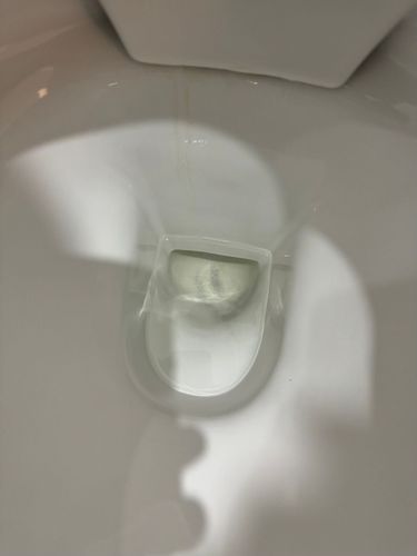

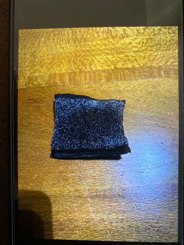

Help our cleaners used a steel wool scrubber in the toilet bowl & have scratched the bowl. Any advice please on how to fix or should I tell them they will be replacing it?

I propose using Bar Keepers Friend 737ml Liquid Soft Cleanser. It is effective at removing rust stains, metal tarnish, mineral deposits, soap scum, and everyday grime.
The toilet water in the pan must first be removed, this can be achieved by using a small hand pail and scooping the water out or using large rags to soak the water out. The area to be treated must be dry otherwise the cleanser will dissipate and not be totally effective.
Once you have all the water out and the pan is dry, grab a dry clean rag and place some cleanser on the affected area. Allow the cleanser to soak for a minute before you start wiping it clean. Vigorously rub the metal scratches until they totally disappear.
If the damage is too deep, I'm afraid it can't be patched or repaired, and the pan will need to be replaced. Please note that you must refill the toilet pan with water after your attempt, this is to prevent sewer gasses from entering your home.

I use pumice. You should be able to sand scratches out with pumice.

Thanks for the suggestion, I'm sure our members will appreciate it. A word of warning, though, that pumice in itself is an abrasive. You need to use caution and to go too heavily on the glazed ceramic bowl, as once that glaze is removed through an abrasive cleaning product or action, it opens up the porcelain beneath, and stains won't come out of that as it is porous.
