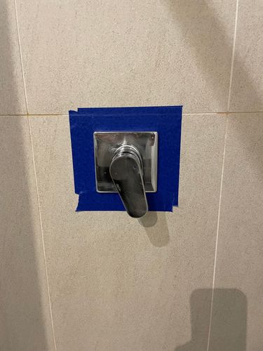

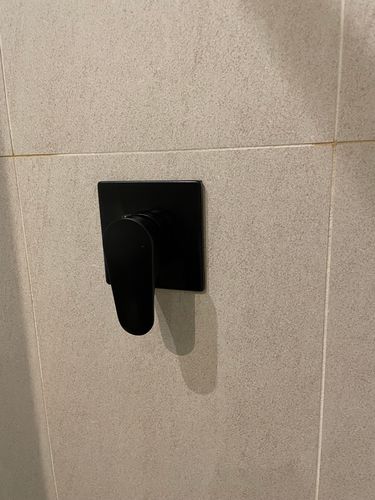

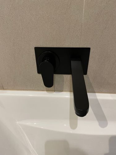

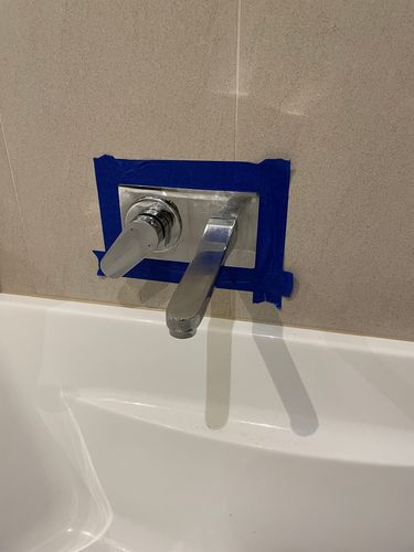

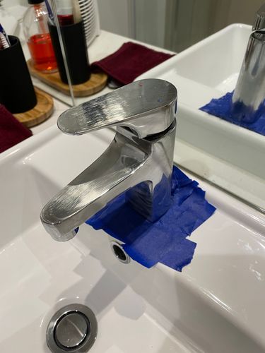

Over the weekend I spray painted the tap and the mixer from one of the bathroom and was pretty impressed with how it turned out. After looking at some prices to buy a brand new one, I thought I would try out the Dulux 300g Metalshield Epoxy Enamel Spray Paint Satin Black first since it would save me a lot of money and it would be such a quick DIY.
Here is how I turned the tapware from chrome to black:
 IMG_4432_jpg.jpegIMG_4178.jpegBeforeBeforeIMG_4168.jpegIMG_4167.jpegAfterAfter
- First cleaned everything really well
- Sanded everywhere with a 240 grid sandpaper
- Cleaned again to make sure it was perfect to start spraying it
- A very important step, tape everything well to make sure spray paint doesn't go anywhere
- Spray following the instructions on the bottle ( I applied 2 coats)
 That's it very easy DIY that makes a total difference.
