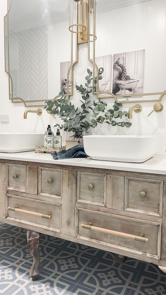

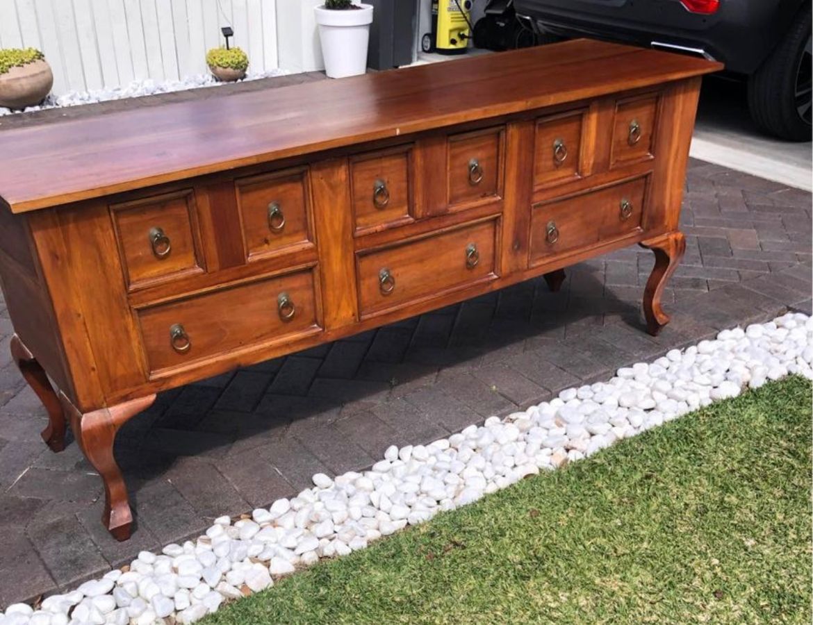

This bathroom will be shared by our 3 kids so I wanted to add a larger vanity, this was proving expensive so I decided to get creative. After searching for some time on marketplace I finally found the piece I was looking for.
It was the size and structure I wanted but aesthetically it wasn’t hitting the mark and I had to figure out what to do with the counter as wood in a bathroom with 3 kids, 5 and under would be disastrous.

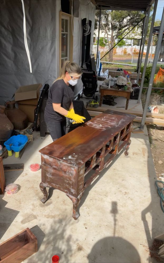

Step One: Remove the Varnish
I used my favourite hack and sprayed oven cleaner all over the vanity and drawers and left it for 30 - 60 minutes. I hosed it off and left the cabinet to dry completely. If the varnish is really thick and heavy you may want to repeat this step, in this case I only needed to do it once.

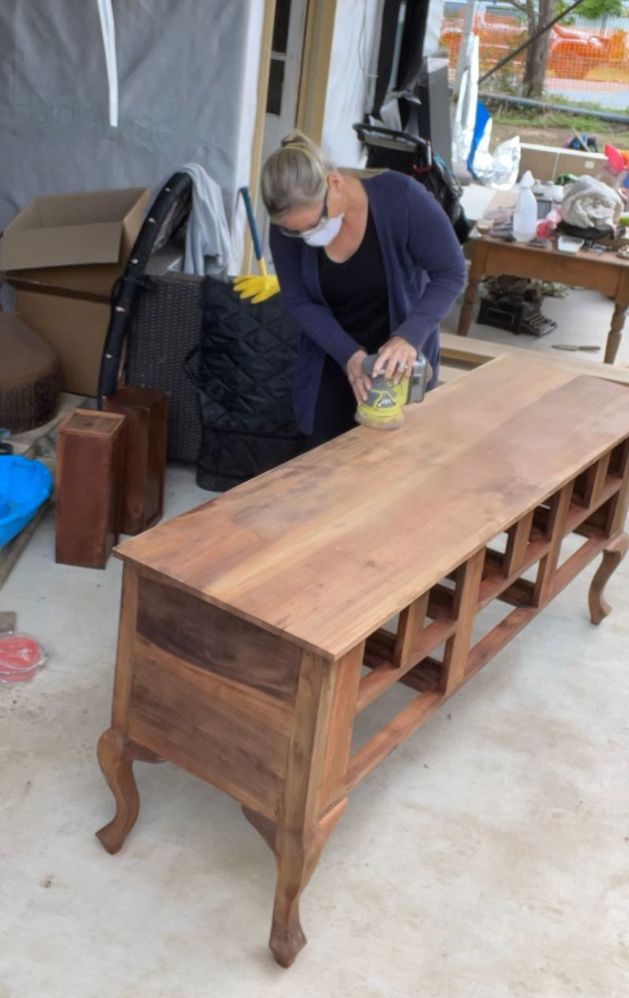

Step Two: Sand
Once the cabinet was completely dry I sanded it. For a more even finish, taking the wood to raw I would suggest giving your wood a fine sanding. I used grit 220, a fine sanding pad using an orbital sander. You can use a sanding block, but it will take a little longer
TIP: When sanding move the sander continuously at a smooth steady pace, do not leave the sander in one place or apply too much pressure as you can gouge the wood.

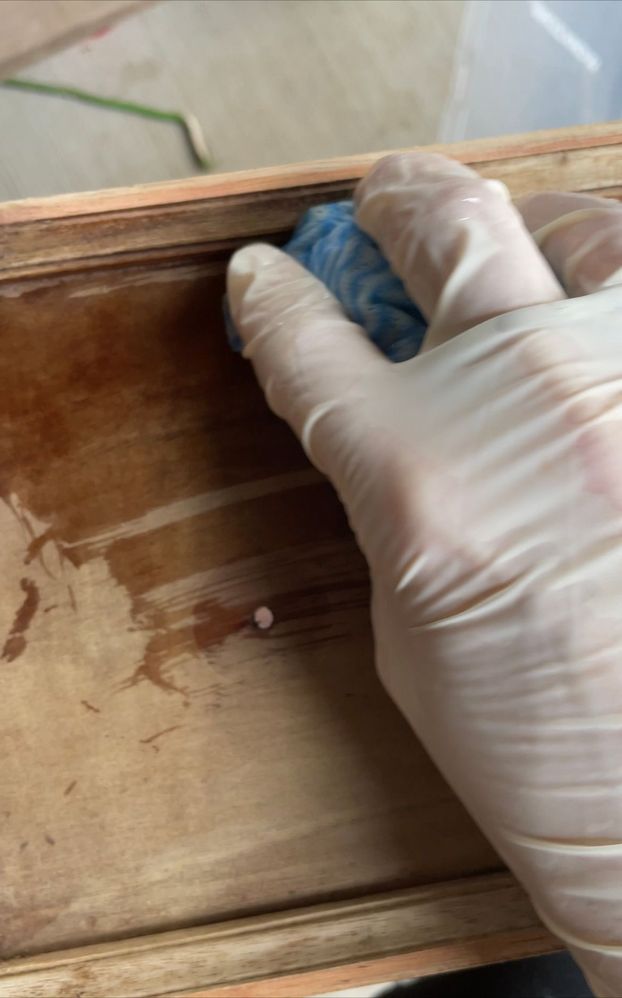

Step Three: Bleach
I poured some household bleach into a container and using a chux cloth I wiped down the cabinet and drawers like you would a stain. Once it’s completely dry you can see the impact of the bleach, to get the look I desired I repeated this step.
TIP: Don’t do the inside of the drawers. I did and couldn’t get a nice even finish so I ended up staining the inside a darker brown.

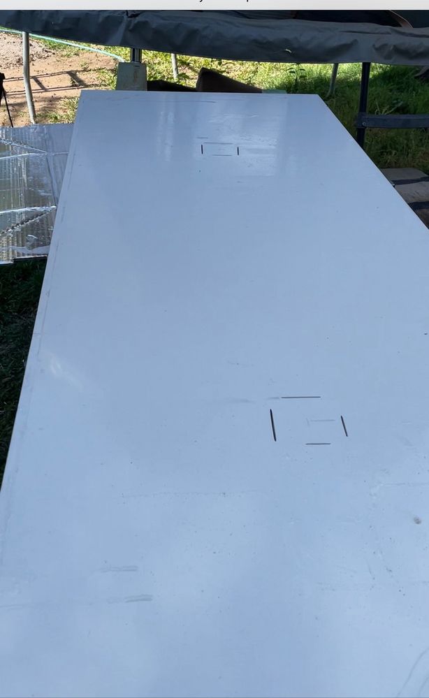

We found an amazing piece of white quartertone (exactly what I was looking for) on the market place. We cut it down using a grinder, keeping it wet during the cut. Then measure out our plumbing holes and made 4 incisions on both sides of the stone, and made the final cut. As this was something we had never done before, we opted for surface-mounted sinks in case we weren’t able to get a neat line, it also meant we didn’t have to build the cabinet up.
We left the stone its original width as we were worried about it cracking, meaning that the counter went from 540 to 620. This worked out wonderfully as the plumbing had been installed from the floor, so it left a void behind the cabinet for the pipes, saving us from losing several drawers. So it wasn’t wasted space, we added some pine at the end of the cabinet by the toilet to create a hidden shelf.
