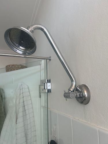

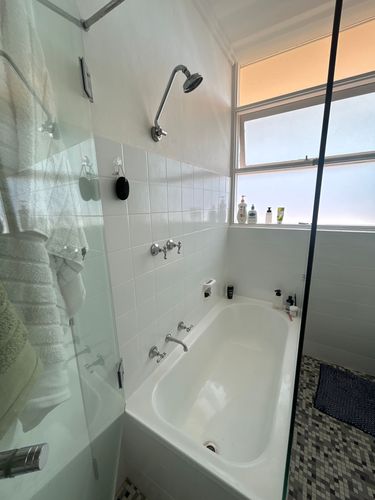

Hi there, I’ve just moved into a new rental and would love advice on upgrading the shower head - both the pressure and height of the current head aren’t the best.
My partner is very tall (2M) so I’d like an extendable arm that goes up higher the current one and then extends toward the middle of the shower so the water falls more centred. Would a gooseneck with rain shower head be a good option? I wasn’t sure how compatible my shower is with that?

The Mondella Rococo 300mm Curved Wall Shower Arm - Chrome is likely going to be the best option. It's 300mm high and extends 300mm out. It's probably much the same height as the current, but it will get the head location out further and pointed down. I'd then go with something like the Mondella Rumba Chrome Rectangular Rain Shower Head WELS 3 Star 9L/min or any other rain shower head.
Two metres is pretty tall, though, so that might not be high enough. The only other option I can find is the Flexispray WELS 3 Star 9L/min Chrome Havana Short Twin System, which could give you around 50mm more height.
There is a possibility of cobbling two Flexispray All Directional Chrome Shower Arms together. It could look a bit janky but it might resolve the issue.
Thank you so much for the advice Mitchell! After reading the reviews I’m going to purchase the Havana short twin system. Having the extra fitting will be handy for cleaning the shower
