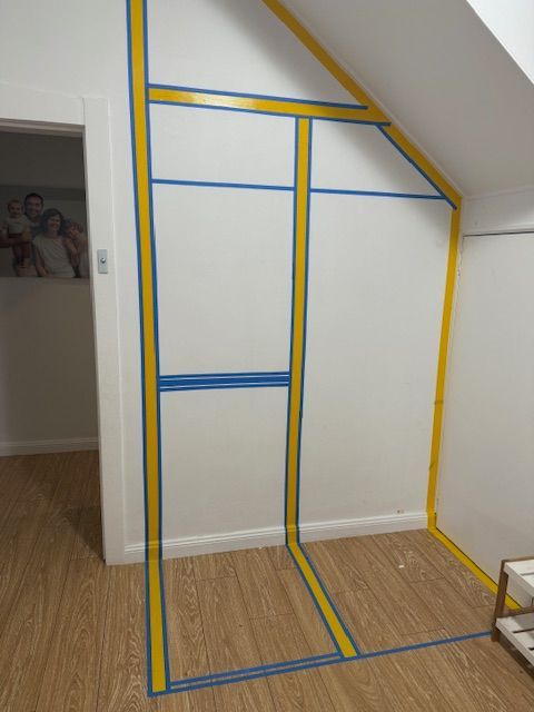

I am building an internal laundry under my stairs using a 70mm x 45mm framing pine, and 18mm MDF paneling. I will put sound reduction paneling within the walls. It will be a vertical laundry (dryer above the washing machine with a sliding shelf in between). Will have a single door overlaying the frame and another door on the other side - the structure will look similar to the picture below. I will also put Spec rite Oak acoustic timber panels on the front of the doors and the frame. My problem is that the doors will now be 40mm deep (21mm acoustic panel on top of 18mm MDF) and I don’t know what hinge would be most appropriate. Can you advise? I expect the hinge to sit on the inside of the left hand beam.laundry map.jpg

We’re currently in the process of picking a new washer and dryer, so I will build the cabinet to that width, with an extra 2.5cm either side and top for ventilation. There is also likely to be a good 10-15cm at the back of the cabinet. Note the dryer will be a Heat pump type dryer that extracts the water and feeds it into the waste water pipe, so its just the heat from using the appliances rather than dryer actually pumping out hot air. I am reluctant to vent into the main room as this will likely negate the impact of the sound proofing I will put in. However, I had planned to put a hinged access panel at the back cupboard wall (centre yellow beam in photo) so I could access the taps/power points from the cupboard (right hand side of the cabinet) when the appliance are fitted. I could turn this into a louvered vent rather than a door. Would this be sufficient for ventilation purposes? i.e. venting into the cupboard on the right hand side?

Thanks for all your advice. One more question on hinges – above the washing machine/dryer space on the left hand side, there will be a cabinet to store washing power, detergent, etc. (In the photo, this is the small area with yellow beams on the top and both sides but not the bottom). Again, this will be 18mm MDF with 21mm acoustic panel on top (on both the door and the panel above) and I have the same hinge dilemma.
I would like these cabinets to open upwards – which means putting the hinges on the top of the door. But I am again concerned about the clearance required for an essentially 40mm thick cupboard door opening upwards and getting jammed against the acoustic panels above it. Are there any types of hinges that bring the door out and open, so it clears the acoustic panel? Another consideration is as this cupboard will open vertically, I probably need a stay-open hinge to ensure it stays open until manually closed. Once again, your advice is greatly appreciated.
