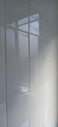

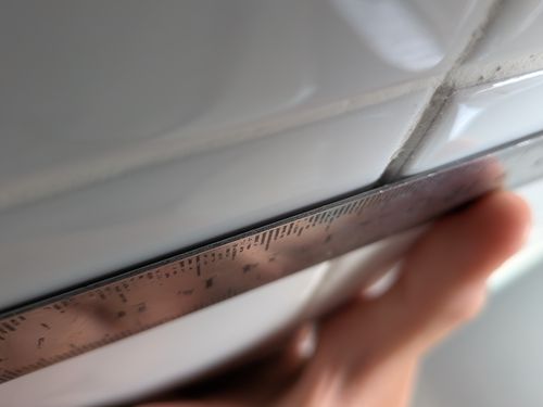

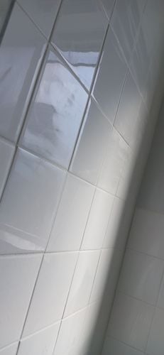

1. New tiles are of wrong color, it is more glossy and more blue than the previous shade of white, is it easy to get new tile of more matching color?
2. Should they have requested my confirmation before starting the tiling?

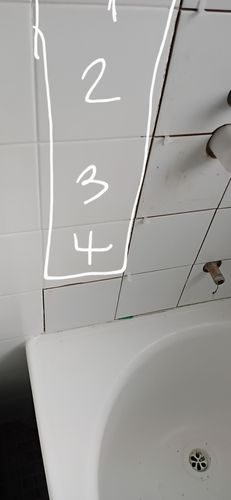

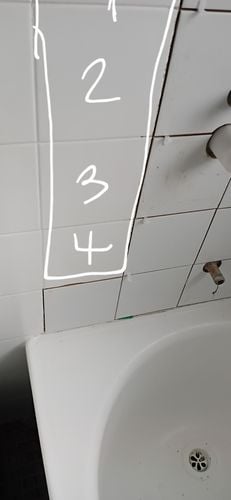

3. Are scattered around in a disorganized pattern. Can I request the tradie to replace four additional tiles, as part of the job, to at least make something resembling a rectangle of a different color.
4. The tiler claims my old tiles are painted over; is this even a thing?

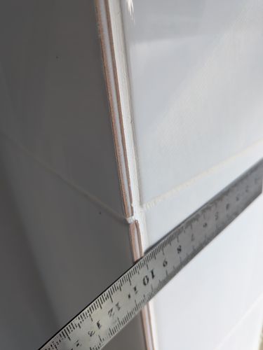

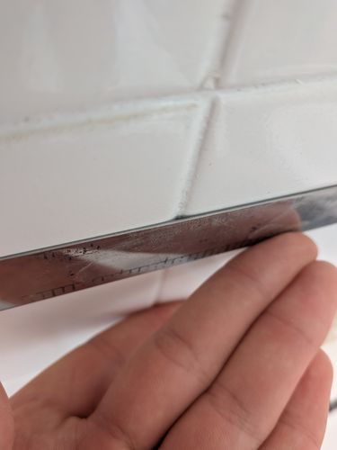

5. One of new tiles is not even with rest of surface. Can i ask them to re-tile it as part of the job? There was villa board behind these rows, it was flat, I am not sure why that one tile even managed to not be flush with rest of surface.

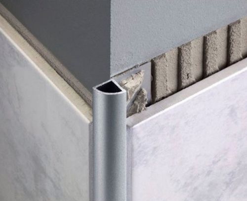

6. Corner tiles were rounded, yet for new tiles they are sharp corners. ![]()

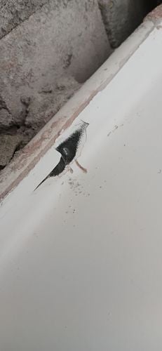

7. They scratched the bath tub in the process, exposing the steel. Solution: tiler adds grout on top of the affected spot. Is this acceptable?

Not even tile:
Different color. And visible that some tiles are not even/flat positioned:
tiles which I think could be good to replace to at least have a rectangle of the other color:
bath tub damage photo, during the job,

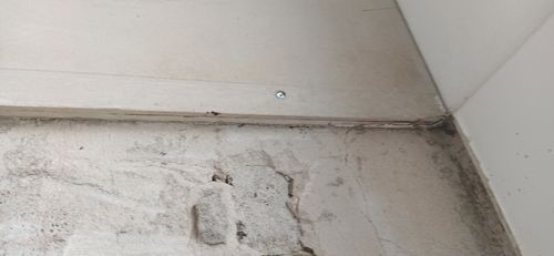

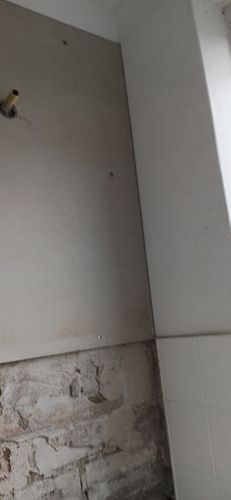

Villa board,
more villa board, at the top half,

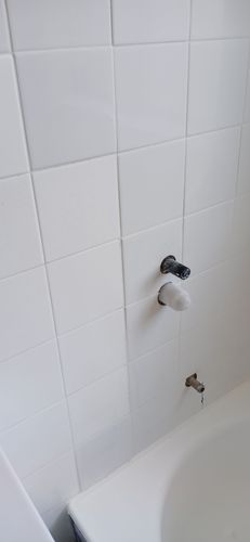

uneven tiles
Sharp corners:
A: Comes down to who supplied the tiles or provided the information and to who? If you provided a brand/style/product code information to the tiler and what was provided is different, then this can be checked against his paperwork and you would be in the right. Batch numbers are very important here too as they can vary in finish. The tile supplier will know this and an experienced tiler would check. Did you check the tiles before they were laid?
No necessarily. It depends on the conversation of who ordered etc as per A1
A: If by what you term as "scattered" that the grout lines don't match up, then thats a sign of a very poor quality job cosmeticly wise.
A: Yes absolutely. This will explain why there is a difference matching new against old. Old painted tiles used poorer quality product which also was a lot matter in finis. Todays tiles paint is very good and can provide a very realistic finish.
A: If the tiles used are essentially dead flat with no textured uneven finish as part of its design, then yes they all should be dead flat (within un-noticeable reason). Another sign of a very poor installation.
A: The tiler should have installed or asked you about installing a rounded edge trim. There are many styles one type attached below.

My first step wouyld be to talk to the tradespeople who have doen the job. The discussion you had with them before they started work outlining what you wanted is the base of the work.
The steps/answers that @Nailbag has put down are exactly the same as my responses would be.
I also agree that it looks to be poor quality. Replacing indervidual tiles will be a headach as to waterproofing the area as it will be damaged if a tile is removed.
First step - talk to trades person.
