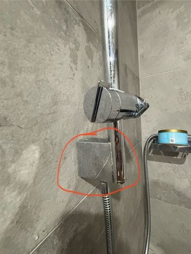

Hi all,
Y shower head holder is broken so I want to replace it with the new one.
anyone knows how I can remove it from the rail? The picture of the rail is attached, seems like the end of the rail is stick with the bottom part so no idea how to remove it.

At the bottom of the rail, you'll see a very well-hidden cover cap. You can see where they join up this thin piece of plastic cover at the bottom of the rail. I suggest using a screwdriver with a sharp edge to pop off the cover. Once the cover is off you should see either a screw or grub screw inside the pipe. Use the necessary tool to remove that screw or grub screw. The same thing is done at the top of the rail. Once the screws have been removed the rail can be pulled towards you to slide out.
Once the rail has been removed you should be able to see the fixing screws used on the rectangular posts on the wall. Again, use the correct tools to remove the screw that is holding it in place. Once the rail has been removed you can now get a new shower rail and attach it to your shower wall.
