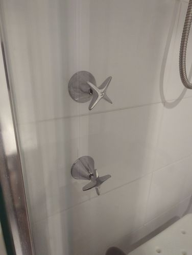

I can't work out how to REPLACE these taps
Is there a special tool required to clip into the back of the tap to remove because I can't find anywhere to be able to remove these
taps

You should inspect all around the tap handles as it's possible there is a grub screw that would need to be removed to allow you to remove the tap handles. If you can't locate a grub screw it may be as simple as rotating the tap handles all the way off the thread on the spindle.

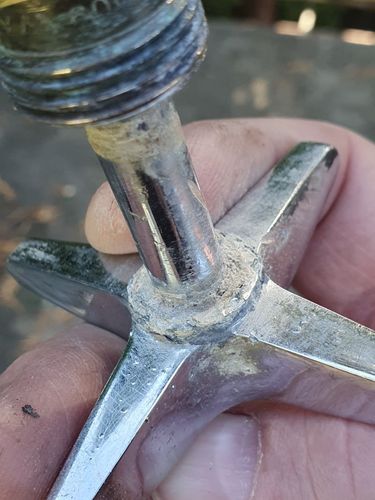

Yes. It's a small two-pronged spanner (similar to an angle grinder spanner) that is meant to fit under the handle. You can buy them in a kit in the plumbing section at Bunnings. They're fragile and easily bent.
I once had the same taps as you which in my case were heavily calcified and made the handle impossible to come off (see below).
The conical flange also can make life difficult. Yours do look a little younger?
