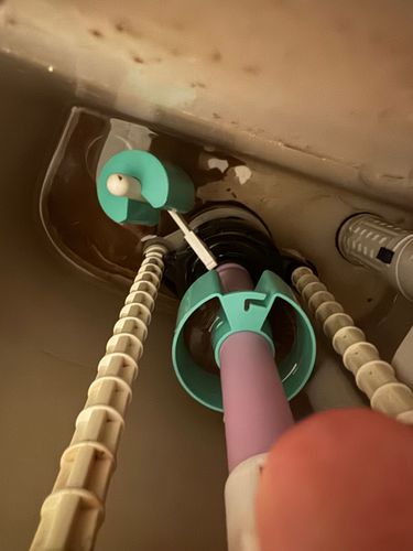

my toilet wont flush due to the outlet breaking. What do you suggest?

I'd suggest you check out step 2 in How to fix a leaking toilet where my colleague @EricL gives guidance on how to remove a flushing valve. Remember to turn off the water and drain the cistern before doing so.
Once removed, you can take it in store and match it up with a replacement flushing valve, then return home to install it.
You might also like to check out How to remove toilet flushing valve and How To Service a Valve for some further guidance.

 Thank you. Ive pulled this out. Do bunnnings have a replacement?
