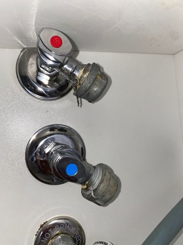

we have just moved into a new established rental property and I’m having trouble trying to take off the caps that is screwed onto the water valves for the washing machine hoses. What tools do I need to undo these, I’ve tried using a shifter and it won’t budge.
Hello @MayZ
Welcome to the Bunnings Workshop community. It's sensational to have you join us, and thanks for sharing your question about removing the caps on your laundry taps.
Since you've tried to use a shifter and could not get a grip, I propose using Multigrip Pliers. It's serrated clamps and adjustable jaws should allow you to grab onto the galvanized cap and turn it anti-clockwise.
However, should that fail, my only other suggestion is to use a Trojan 300mm Pipe Wrench. This wrench is specifically designed to grip onto galvanized pipework. My best advice is to make sure that the taps are in the off position before you remove the caps.

Hi eric
thank you so much. Ended up getting some multi grip pliers which done the job 😊
