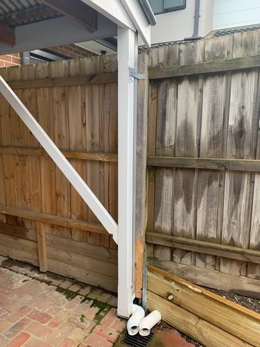

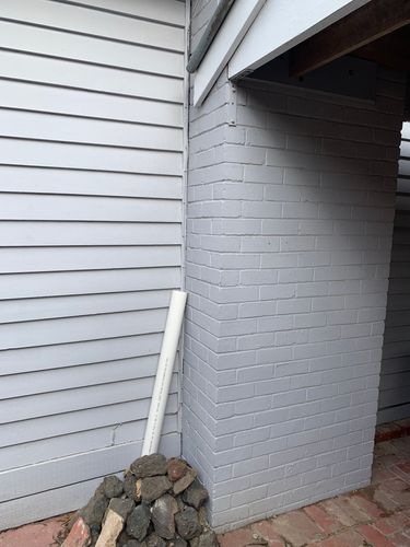

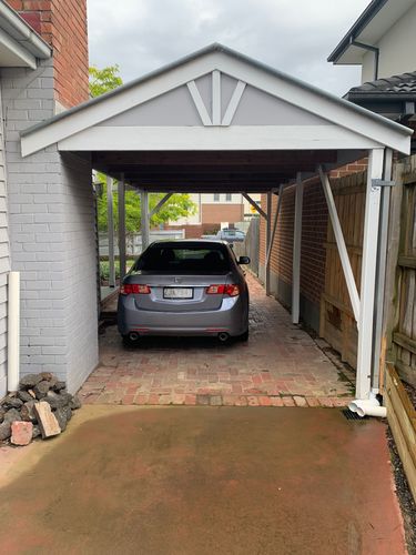

Im hoping to erect a gate on the back of my carport. I’ve see the Bunnings adjustable gate system. Is it easy to set it up?

Please post a couple of photos of the area.

I have sent some photos. Hoping they come to all who asked!

Hi @philbyone,
Thank you for sending those photos through. They are a great help.
Selecting gates that are appropriate for the opening will be the main thing we have to get right. From there, it is just a matter of mounting them and adding hardware to ensure they stay where they are supposed to.
How wide is the gap between the carport post and the brick wall?
Can you send a link to the specific gate you were looking at?
RapidFence have a wide variety of styles, so knowing which one you are thinking of using will help us offer specific advice on that type of gate.
At present, the carport post looks like a logical place to attach a gate, but if you needed to use a dual gate, you would have to mount a post to the brick on the opposite side of the opening, so you have something to attach your gate to. This would be relatively simple using a pine post and some masonry anchors.
If you were using dual gates, you would need to put some holes in the brick pavers and add drop bolts to keep the gates in place.
I will assist further when you can get back to us.

The gap between brick and car-port post is 2.8meters the brick wall and the outside of the carport post are aligned. I’m thinking of two swinging gates big one on brick side. I have sent you a photo of Bunnings rapid fence we looked at. By the way does everyone see this info I’m sending you or just you?

A combination of the RapidFence 1800 x 1870mm Gate Frame Kit and RapidFence 1200 x 1870mm Gate Frame Kit should be perfect.
As I mentioned, you will have to mount a post to the brick side of the opening, but that shouldn't be too difficult.
Once that post is in place, you'd just adjust the gate frames to the desired size, screw the hinges to the posts, and then attach palings using metal screws
Once the palings are in place, you would attach the drop bolts I mentioned and attach a suitable gate latch.
