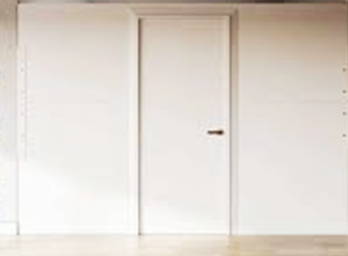

i want to estimate materials and cost to build a wall similar to this photo? approximately 3M x 5M

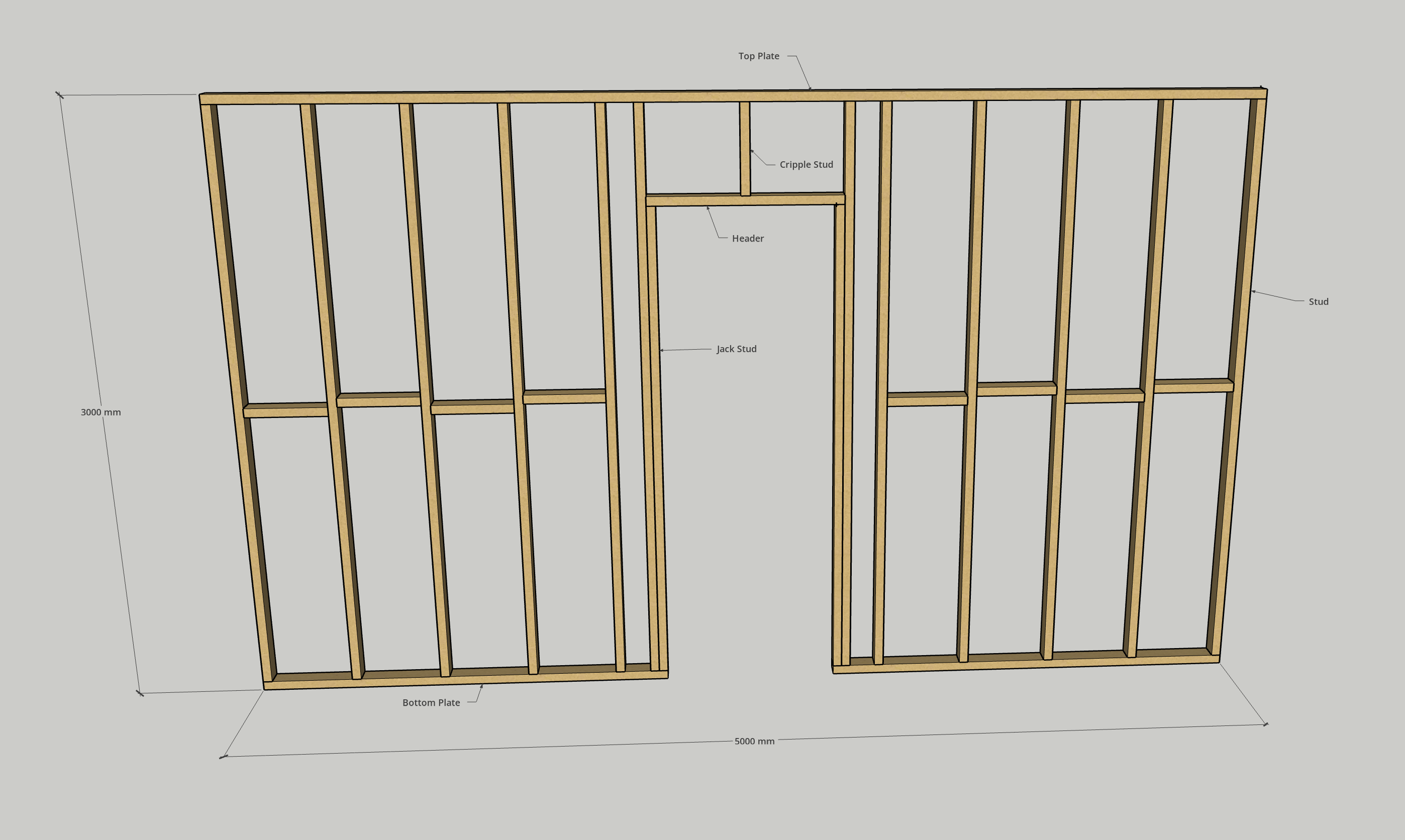

For a wall that is 3m tall by 5m wide with a door in the middle, you will need a top and bottom plate, 12 full-height studs, two king studs (a bit taller than the height of the door), a header which is the width of the door, noggins and a cripple stud (sits above the door).
Using this framing layout as a guide, you would need approximately 57 lineal metres of framing. It's a good idea to allow 10% for wastage and errors, so working with around 62 lineal metres of framing is a good start.
