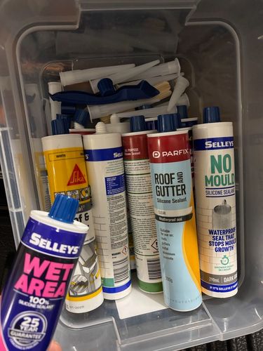

Has any member come up with a sure fire way of capping silicone tubes/liquid nails/no more gaps etc after use?  I have tried screws, caps, bolts etc without much luck.  Electrical tape seems to work for up to 2 weeks but air still seems to get in to set the silicone in the dispenser tube.  I hate cleaning out the dispenser every time I need to use a product.

Keep the plastic nozzle on the tube and squeeze a small amount of silicone out of the tip to form a plug.
I also put a small piece of plastic between the tube and nozzle as per this youtube clip.
Or use a silicone end cap. Then wrap everything up in plastic with elastic band.

I don't have much luck with the Sika ones @MitchellMc as the caps don't seal very well especially if you have to change the trim angle of the tips. But the Monarch ones work a treat and makes for more compact storage too.
