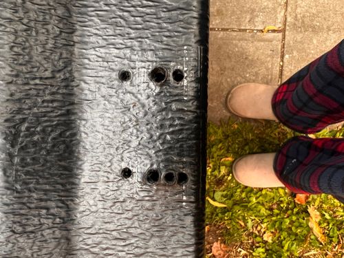

The new top / movable tray has a latch and the guy who has installed it added a closing latch to the tailgate (remember the picture with those 6 holes in the plastic cover?!). Supposedly to make it lockable; which it never was - right from the start.

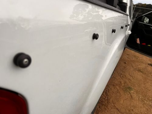

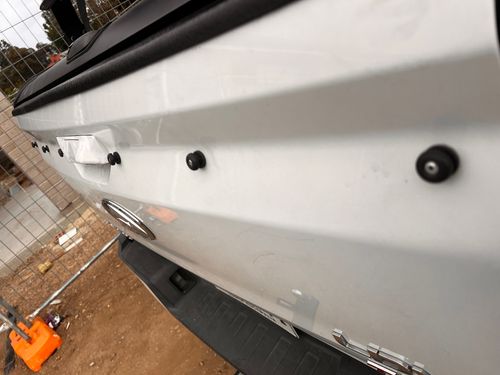

I added some more pictures of a row of little round pins to where the tarp initially was attached to.

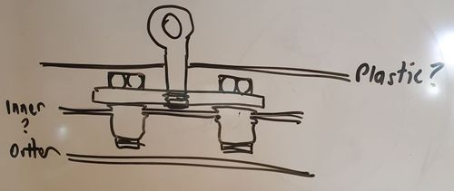

I am thinking its just a protective cover and to make it loook nicer. Your sketch works showing what I was meaning

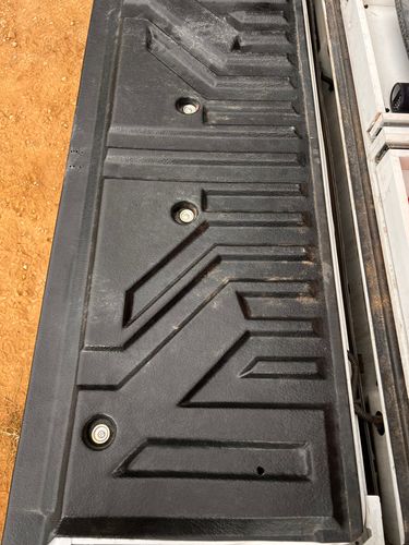

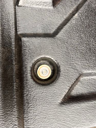

@Noyade yes it is; but only attached via hidden screws. However I removed the caps for faster access to the metal underneath.
see below picture
Ok - thanks Dave. I was wondering if I should take my nut rivets and depart. 😁.
I have a twin-layered Holden Rodeo tailgate where it would work - just not sure what's to happen with the eyebolt @Sybilla?
