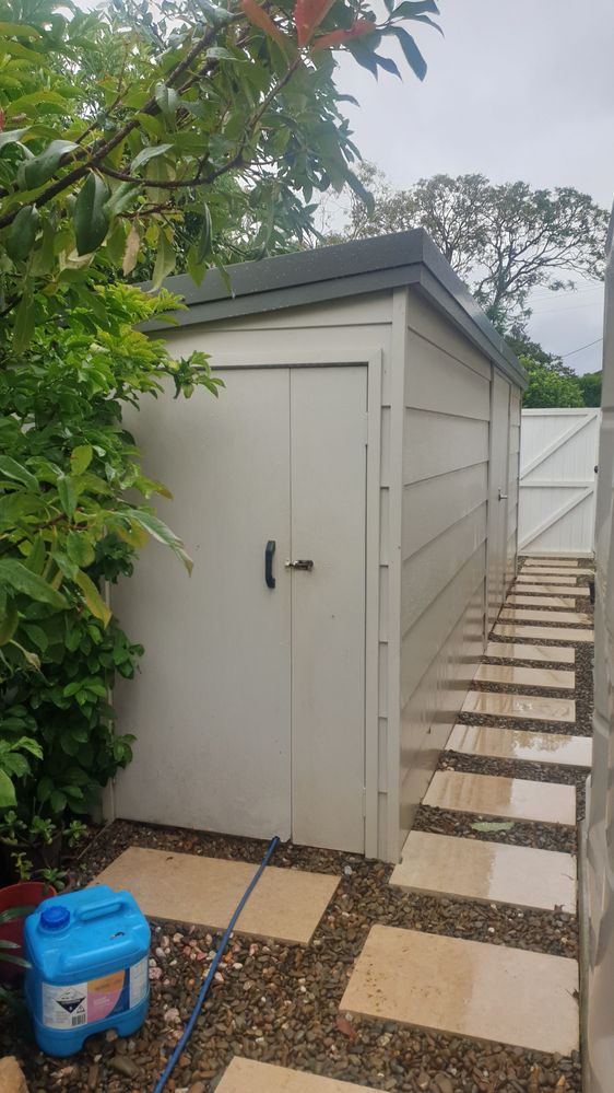

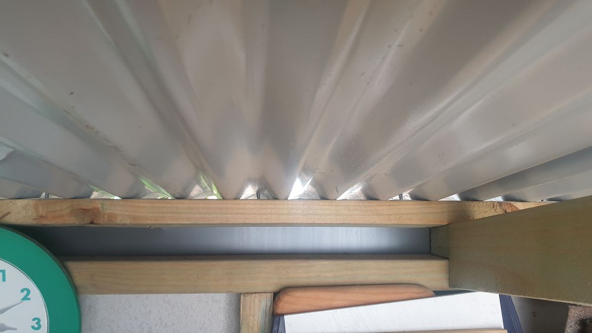

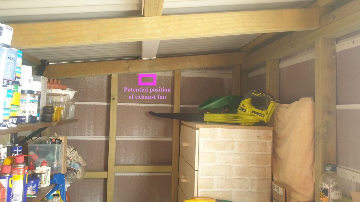

Please see some photos of the shed, inside and out.Potential position of foilboard sitting on top of the rafter
5cm wall gap from top of wall to roof. Wall is between sections of the shed
? enough air in from corrugations
Northern side of shed, looking south
Southern side of shed looking north
Southern wall inside shed

Mitchell, just one more question- will this CSR Solar XVent just sit on the corrugated roof, or are you suggesting it go onto the northern end wall?
The sun disappears from this wall around 2pm so it may not be suitable to get enough heat out before the cooler evening.
What would be a wired version you could also recommend for this space?

When you say use builders glue, are you saying I glue it directly to the underside of the colour bond roof? Install it like a sheet, or follow the profile of the corrugated roof to minimise air gaps?

@Ritar Your retro fit.
The EPE foam is not 100% stiff and can be spanned short distances over the roof, sagging wont look good , I want your shed to look good for you, too.
In the attached edited photo it shows extra roof battens level with the top of the beam to sit any insulation on flat.
OR Ok second thought you might as well put the battens on top of rafters as insulation will flex over the bumps. The more battens you have the less the sag in the insulation you can put glue on after foil is in place sqirt up on top of batton below insulation gravity will set it down to the batten . This wont look perfect but more industrial. So lets explore ideas more.
Flat internal roof
You could even use 4-6mm ply cut sheets and make a internal roof lining (painted? your choice) which will capture sandwich the insulation between the roof (and can breath via side roof corragations under the roof.. Screw the sheeting directly to the battons with the insulation on top with glue tack points just to stop it moving, See diagram blue roof panels Plus optional blue insulated sidewall flat lining or just insulation.
You maybe able to attach all this to existing timber side rafters or just add more battons. Center battens do not screw directly below side wiring. in case some one later uses long screw hits the wire.
A cant estimate how much clearance you have above the light fitting or if it is safe so probably best to cut around light fitting .
To be super safe contact a qualified electrician to verify your installation poses no risks.
Optional Static vents work 24/7 one at each end of the shed will cool as a though breeze and they are inexpesive this may be enough not to need roof vent.
If you later use roof vent place it as high as you can get in the ceiling in shed centre.
Please use this as a guide only to formulate your own design
The CSR solar vent would need to go on the roof, though I presumed you might be thinking of going with a powered unit on the wall, given your illustration, @Ritar.
Any of these slimline exhaust fans would work well for powered units.
