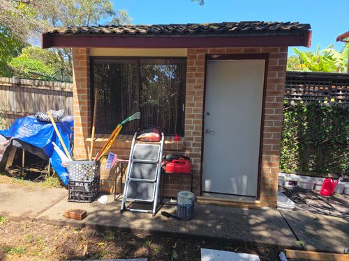

This is a photo of the front of the shed so you have a better idea

Good Morning @Nuggets
Thank you for the photo.
You could try the screen idea on the left of your shed, maybe the right as well if the sun hits the wall.
I am not sure how far from the fence the rear of teh shed is but if teh sun hits that wall as well then I would also install a screen.
Seeing that you have a tiled roof on the shed I am wondering if you have sarking under it? Whichever way Insulation bats installed would help bring the heat down.
With the window being so large, Rubber backed curtains on the inside and maybe a canvas awning hanging in front for summer sun.
