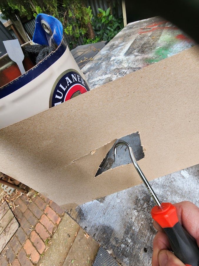

Definitely get that 'door' piece out. My thought was a large O-ring puller (many shapes and sizes available).
Should it fall inside and beyond finger reach, try one of those nifty wire grabbers.
