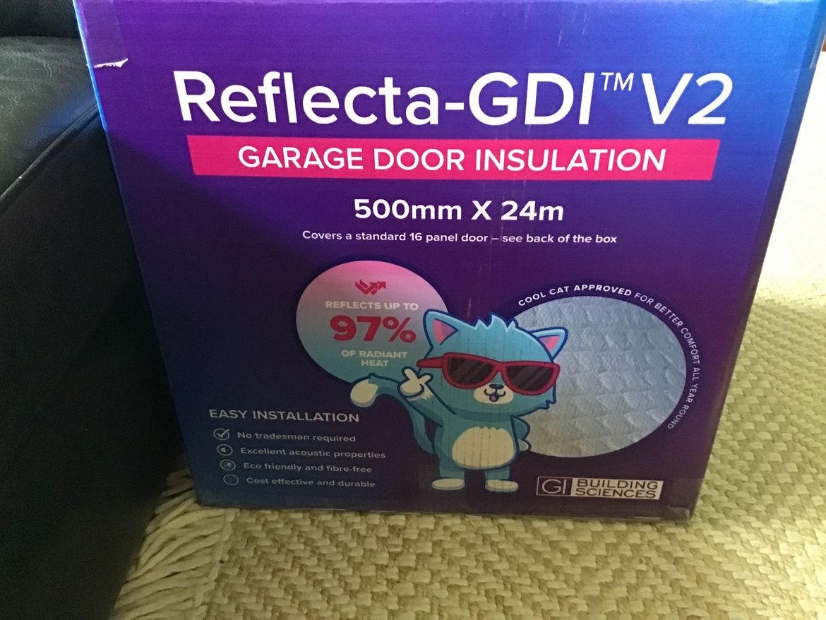

i I have a Reflecta garage door insulation kit to fit,
wondering what is the best silastic to use to stick the 10 mm insulation to the roller door

I tried to contact Reflecta GDI but they are closed for the Holidays and will be back after new year. I also looked into their installation manual but there was no mention on the brand of silicone to use. Is your roller door a large panel type system or small individual panels?
Here is the link to the installation page: Reflecta GDI
I propose having a look at the Selleys 310g Translucent Roof And Gutter Silicone Sealant. It is 100% silicone and is neutral cure. This means that it does not use acid-based chemicals which can harm material surfaces.

The Selleys 310g Translucent Roof And Gutter Silicone Sealant is the correct silicone to use as per the manufacturers' guidelines.

hi @MitchellMc and @EricL , I have one doubt about this silicone. In the description, it says "Not for use on polyethylene, polypropylene or Teflon". However, Reflecta GDI seems to have a polyethylene material that is possibly incompatible with this silicone. Sorry, I haven't seen physically the Reflecta GDI. Kindly advise.
Hi @dhanz15
Thanks for sharing your concern about the silicone. If you have a look at the GI Building Sciences 10mm 0.5 x 24m 12m² Reflecta Garage Door Insulation on the Bunnings website, you'll see several pictures of the product. The second picture shows the construction of the roll with the aluminium lining both on the top and bottom with the polyethylene in the middle.
You are correct that the silicone is not compatible with polyethylene. But the silicone will be adhering to the aluminium foil surface not the polyethylene.
