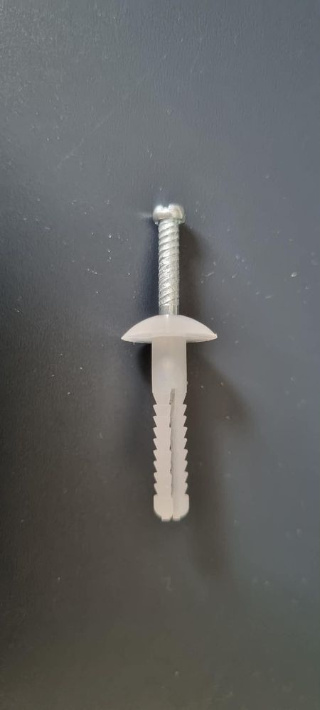

Screws that came with garage seals

You will need a masonry drill bit to make the holes for your plugs and screws. The size of the bit should match the cylindrical part of the plug (the part under the wide head), so if your kit doesn’t specify, just hold the plug against the bit to check the fit.
Your Ryobi hammer drill is perfect for this. Switch it to the hammer function (usually marked with a hammer symbol) and drill at a slow, controlled speed and at about a quarter throttle. Drilling too fast can overheat and damage the bit.
