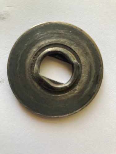

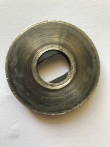

Several years ago I purchased a GMC Circular saw from Bunnings. It was Model MX1275 1200W & 184mm blade.
The saw has worked flawlessly and is still fully operational but not usable.
It has a 16mm blad arbour (bore in centre of blade for fitting)
The reason it is no longer usable is that, because it needed a blade with more teeth, it was recently fitted with a new blade that had a 20mm arbour that came with a 16mm adaptor.
Unfortunately, for whatever reason, when used the adaptor failed and the outer blade flange was damaged. The inner one appears to be o.k. still but I can't be sure until I'm able to refit a blade and try it out. So a pair is ideally what I need.
I attempted to get a replacement from Bunnings by visiting an information centre in store. Sadly, I was simply told that GMC were out of business and there was nothing Bunnings could do. - A somewhat disappointing response.
So, I wonder, is there anyone out there who has a similar GMC circular saw that is no longer working but still has an outer blade flange in sound condition. I would be prepared to pay a reasonable amount for the part and postage if anyone can help.
As the above request is probably a long shot, it would also be helpful if anyone could suggest where I might have a chance of obtaining such a part or, at least, the specifications so that I could get one made by an appropriate tradesman.
Thank you for reading.

outer retaining flange outer side
outer retaining flange inner side

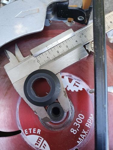

This is an old GMC 184mm saw. I don't know the model number.
16mm appears to be common but it's the flat section that changes with each saw. To my eyes this is around 13.25-13.5mm.
What dimension do you have?

"Excuse me but did you measure inside the gap?"
Yes, probably 13.6mm - just a fraction bigger so it fits over the spindle. Clearly too big for your GMC.In addition to the suggestions above - have you looked at pawnbrokers for a replacement saw? The World is turning to batteries and corded saws seem to be very cheap there. The Skil and big GMC seen below were $15 and $25 respectively. Neither saw had ever been used and the GMC came with the original packaging and usually with three months warranty.
