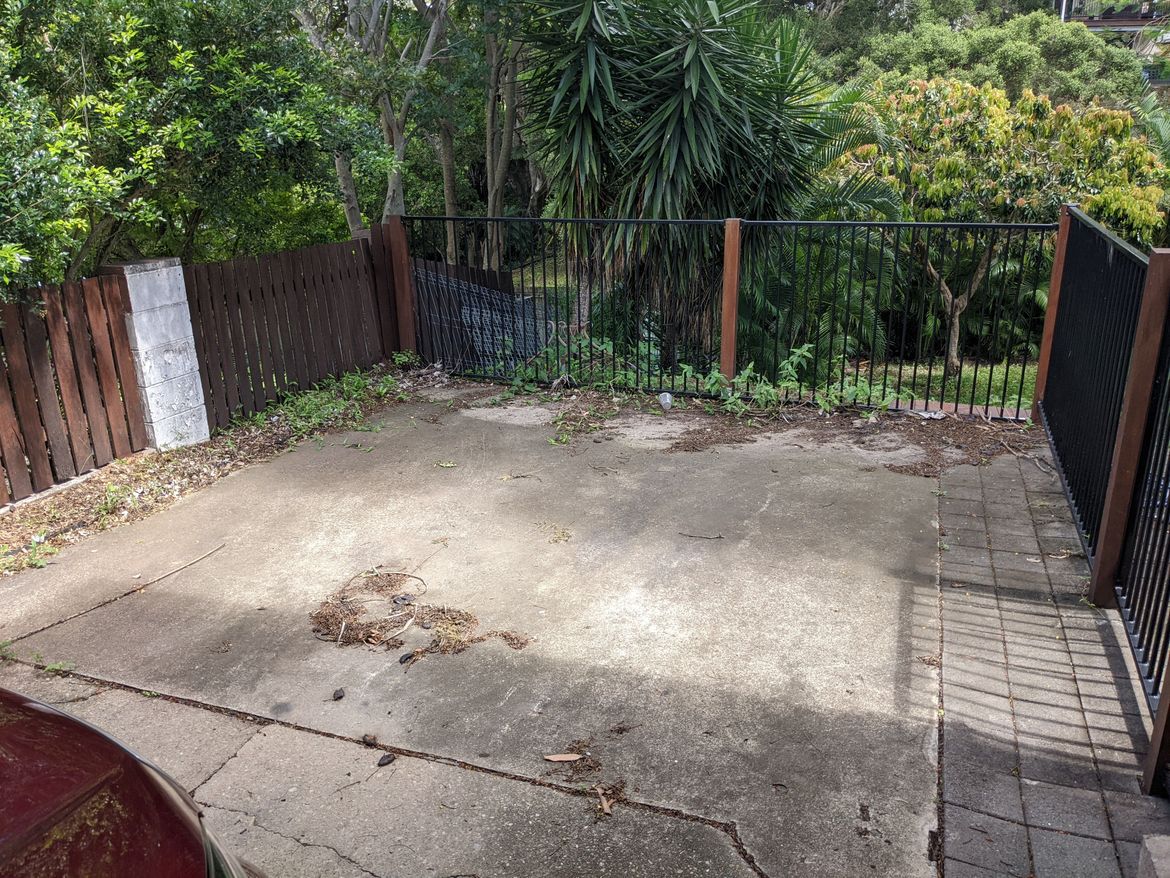

I’ve got an existing slab off my driveway.
I’d like to bolt a small garden shed directly on to (3m x 2m x 2m).
The slab it stills on will be bigger that that so water will likely sit (there is a little bit of a slope)
I had planned to pressure clean the concrete and then bolt the shed straight to the slab and just put some pavers in there to keep the contents off the ground. Lawnmower etc so nothing too precious.
Should I apply the bitumen backed flashing tape directly to the bottom of the shed and then bolt it on? Or foam tape etc.
Any advice would be appreciated
