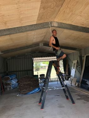

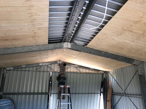

The following weekend we hired a digger and dug out a trench from the shed to under the house. We installed the conduit and cables ourselves as luckily my partner is a directional driller so he knew what he was doing and it cut a large cost from our bill from the sparky. Once the electricity cables were installed we started the insulation and sheeting for the ceiling.
Now, we didn't have that much money to start this project so we had to compromise and just not use battens to hold the insulation in.
This made the ceiling so much harder to do. It took us 2.5 days to install all of the insulation and ply sheets to the ceiling. We had to install a panel of ply and then put the insulation in 1 panel at a time. We tried hacks as to how to hold the insulation in place but none worked.
We used 12mm plywood so its safe to say our arms and calf muscles were like jelly by the Sunday afternoon as it was just myself and my partner doing it. The back of my legs were so bruised from leaning on the ladder while holding the ply above my head. But my god that feeling of relief and excitement after the ceiling was done was next level. I'm so proud of us both as neither of us have any experience in building.

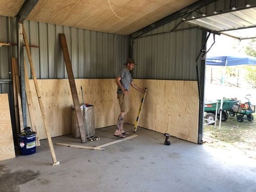

Last weekend we started the bottom of the walls as we only had a few hours on the Sunday to do anything with the shed.
We have probably installed the walls the hard way but it's what has worked for us. We cut the ply to fit the bottom panel and then install a batten at the top of the wall to screw the top half to.
