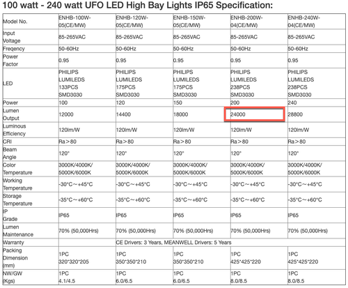

Heres an example of the tech specs of similar light you're looking at.  Ive just outline the 200w in my case, so it will output approx 24000 lumens

Plug these values into the lux-lumen calculator in the link above and as you can see I've got a nice bright work area in the range for technical assembly  I could go down to 150w watt to maintain my 700Lux requirements at the given heights..

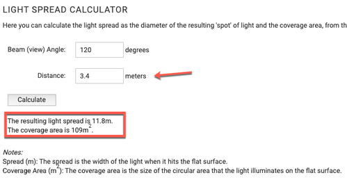

Step 4 - Next thing is to see what area will be covered by the lights
Using the same page in the online calculators use the Light Spread calculator and use 120deg or whatever is stipulated in the technical specs for beam angle for the given light.  The result will be the coverage in m.  In my case the light spread is 11.8m from the install light height (3.4m) to the floor, or could be to your working height, if you want to make sure your bench is covered on the edge of your garage then use working height.  My garage is 6.4 m wide so covers the width no problems and also covers the length from garage door to my workshop door, therefore I only need a single light to cover my garage space.
