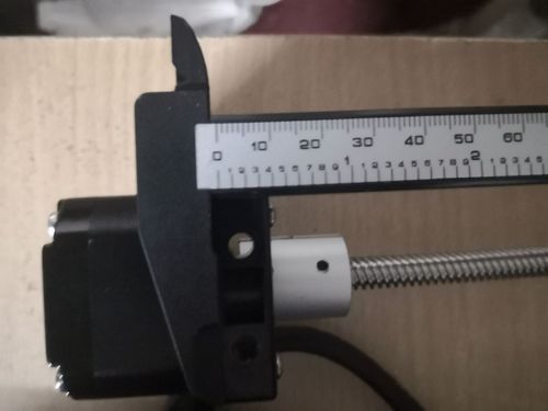

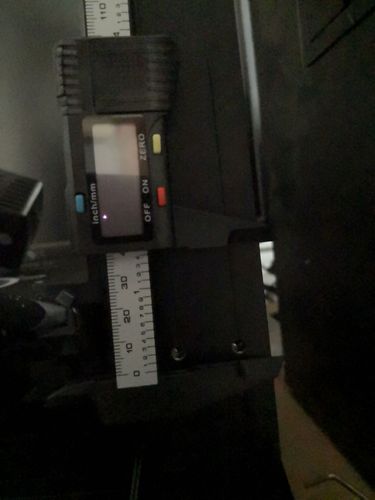

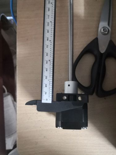

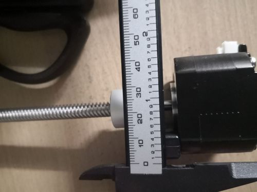

 this is a question about the elegoo neptune 2 stepper motor for the z axis with the 2 screw that connect it to the frame

I'm not particularly familiar with 3d printers, but isn't pages 7-11 referring to the X-axis @Walter? Whereas, we are looking to attach the big screw thingymabob that operates the Z-axis? Would that be page 5? If so, I'd presume that you'd need countersunk M4mm x 20mm bolts from the code.
It looks like these Pinnacle M4 x 20mm Zinc Plated Round Head Bolts And Nuts would be the closest we have. They don't have the countersunk head, which is likely used to give you more clearance between the head and the coupler in front of it. It is best to check that the coupler clears them before start-up and that the stepper motor is solidly mounted once installed.
You need something like this Zenith M5 x 19mm 316 Stainless Steel Countersunk Head Bolt And Nut but in a 4mm. It might be worth checking with your local stores Special Orders team to see if they can order a pack in for you.

Yeah, thanks for that, Page 5  :-). When I was looking at the PDF on the 'puter screen, it was page 11 on the "navigtion bar" on the left.
On the printer, the "Z" motor doesn't move around, just turns the rod, so that the bar goes up and down and the required rate, so I'm pretty sure the bolts you have recommended should be OK for a fix.
