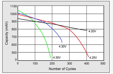

Actually @Noyade lithium cells do have a limited number of cycles in their lifetime (300 - 500), as they age the capacity also reduces thus older well used batteries have a lower overall capacity and will reach an unserviceable voltage sooner than newer battery packs if left in a low state of charge, temperature also has an impact on battery cycle/health (further details in link below) 👍
https://batteryuniversity.com/article/bu-808-how-to-prolong-lithium-based-batteries#:~:text=For%20ex....
