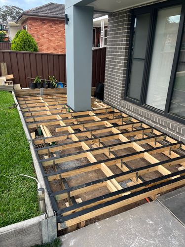

i finally got stuck into it. Have made a lot of little mistakes along the way - and it’s not perfect - but it’s better than I had expected.
I have now decided to buy a tonne of blue metal to go on top of the current dirt (hopefully to stop some of the dirt splatting before I finally do the drck over the top.
i have done a mixture of 350/400 joist centres (working around obstacles) … I am concerned that now I am reading up and it says I should have 350 max spans for composite decking. Hopefully It will be fine). Frame feels extremely solid.

Cant really see any in your pic.
I dont think the differences will be an issue, tho I am wondering why you are putting down the gravel? Once the deck is over the dirt there will be minimal spashing and weeds will be unlikely to grow.

The max span on Ekodeck composite decking is 450mm, which will be fine with your current layout.
ta da
added the gravel because it’s very low and the I’ll likely get a fair bit of water around there. My wife and I are very happy thanks everyone. It to oil it.
