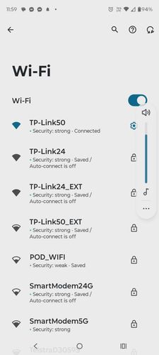

That's a question you should not have needed to ask because I should have included the possibility of needing a wi-fi range extender - plus the extra cost. Let's see if we can check the wi-fi coverage out there near the weatherproof power point using your phone.
Here is my Motorola g84 listing the available wi-fi networks.
Can you do the same and walk outside to the power point area, the signal level will drop but hopefully your connection will remain stable.
If it does you should not need a wi-fi range extender but... we should be prepared for the possibility of needing one like this one because there are variables including RFI (Radio Frequency Interference).
Let us know how things work out...
