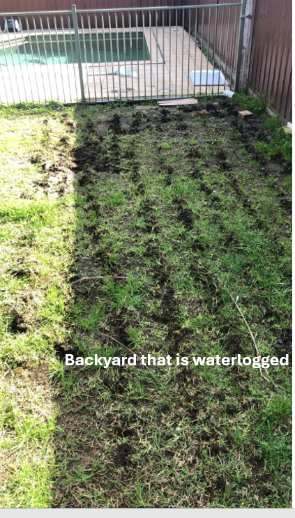

Hi all, my backyard is suffering from waterlogged clay soil.
Previous owners never looked after the yard. Or had proper drainage.

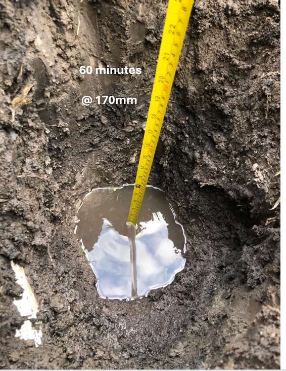

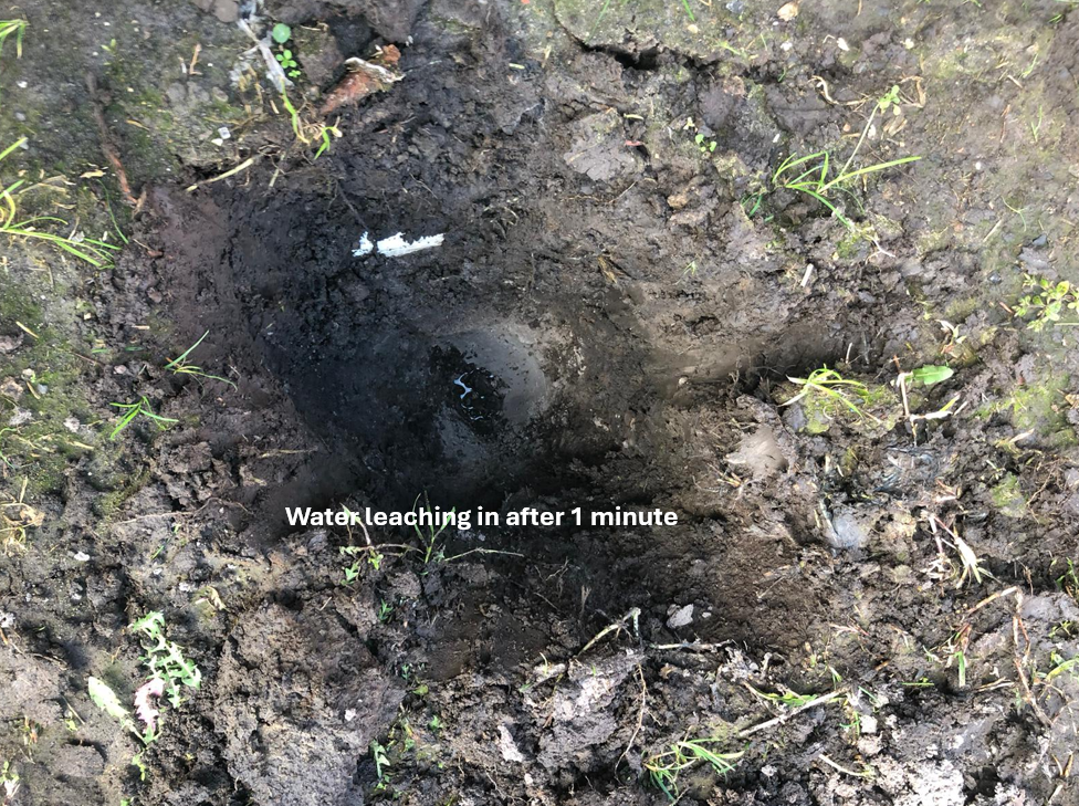

We have a high water table, when I dig down 2 foot we are hitting the water table. I am thinking of digging 3-4 feet down and include a series of french drains that will be linked to an easement in the yard.
Would this be the best approach?
The soil is waterlogged when walking on it and doesn't dry out even after long periods of no rain. The neighbours say it is a high watertable so nothing can be done, I'm not so sure. Some other parts of the yard are like this, and others are not. Keen to hear your thoughts and I'll keep you updated on my progress!

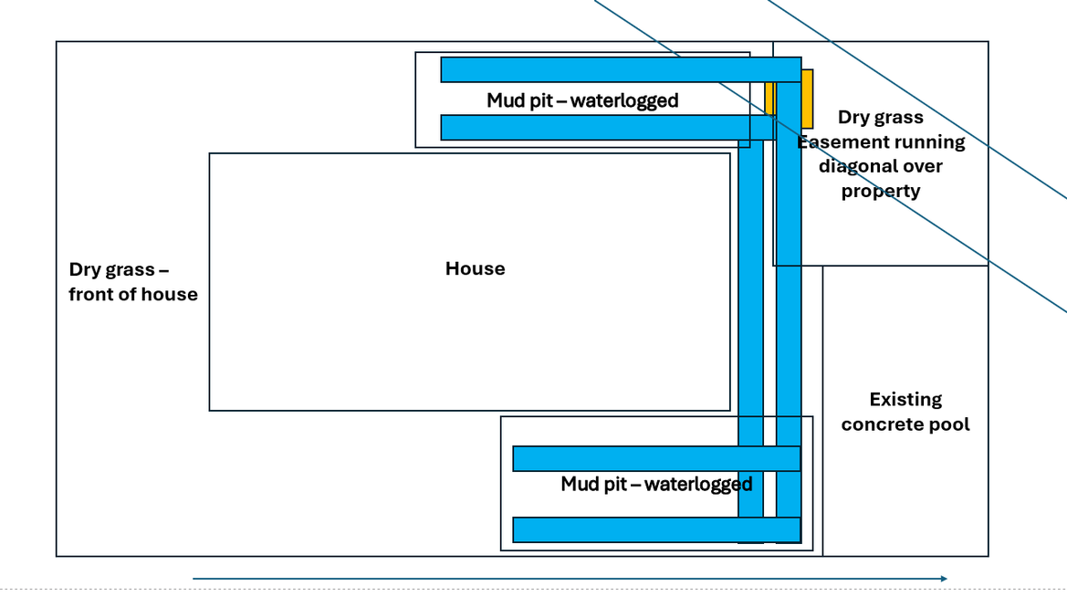

Putting in the French drains sounds like a good plan. Would it be possible for you to draw your drainage plans on paper and sharing it with the community. This will give us a better idea of its size and scope. My only other thoughts are to engage the services of a landscaping specialist who has experience in drainage and waterlogged soil.

I have done a rough design. The blue will be the french drain, the orange box will be service into the easement. The property has a slight fall from the front to the back of the property. Any further suggestions would be super. I looked at the posts you mentioned, thank you. Very similar issue, my pitch fork went all the way in like a hot knife in butter. 5.PNG

When you say parts of your yard are drier would it be possible to have a couple of pics of the overall yard?
The idea of a French styled drain with gravel in it sounds like an idea, tho not sure if I would dig it as deep at 4 foot. If you hit water at 2 foot I would suggest to have the trench at that depth with someplace for the water to drain to.
After I installed new sewage pipes across my yard in a diagonal line you could see the subsurface water change as the ground and grass were a lot less green. I put it down the the two foot deep trench (600mm) with 8mm gravel around the pipe acting like a subsurface drain. For you I would try and figure out which way the water is draining. BTW I live on a hill, not step but has a slope

The advice I was going to suggest is exactly the one in the link that @EricL provided. I’ve installed several of these systems to address the very same issues your facing.
It’s quite an easy DIY project albeit a physical one that doesn’t require any special tools. But either a landscaper or plumber will be able to perform the work if preferred.
Though often a landscaper does it, only a plumber is legally permitted to make the final connection to the properties storm water system. It’s important this is done correctly and no short cutting because it’s closer to cut in to the sewer which a plumber would never do.
