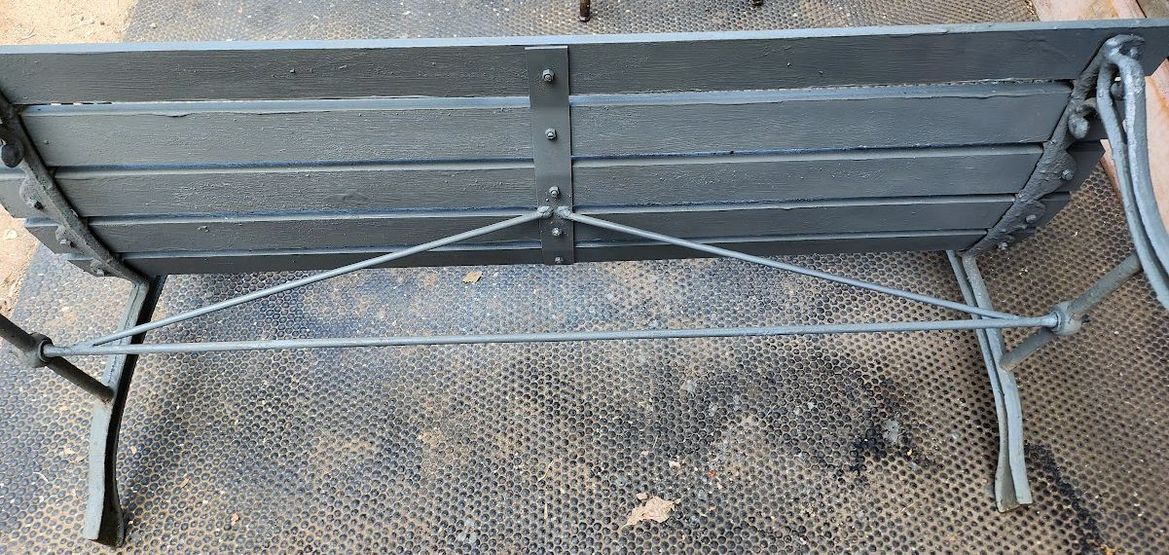

Well I've decided I'm gonna just go with pine.
And brace the seat area with Gal steel plate and weld support rods from it.
My theory is the more support there is, the less likely Sticker's situation above can occur.

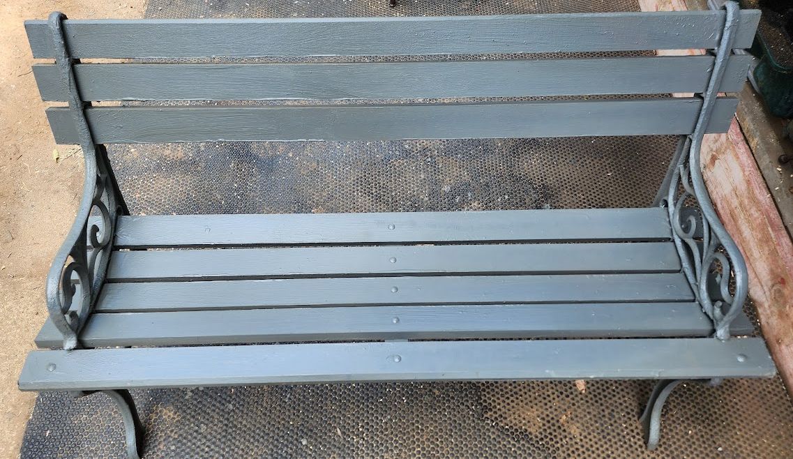

Worked out okay.
The extra steel works very well.

Re: How to replace cast iron bench slats?
Hi @Noyade ,
Great job! The seat would add to a nice spot in the garden for relaxing or entertaining.
Hi @Noyade,
That certainly looks like it is going to be much sturdier.
Nice work, as usual.
