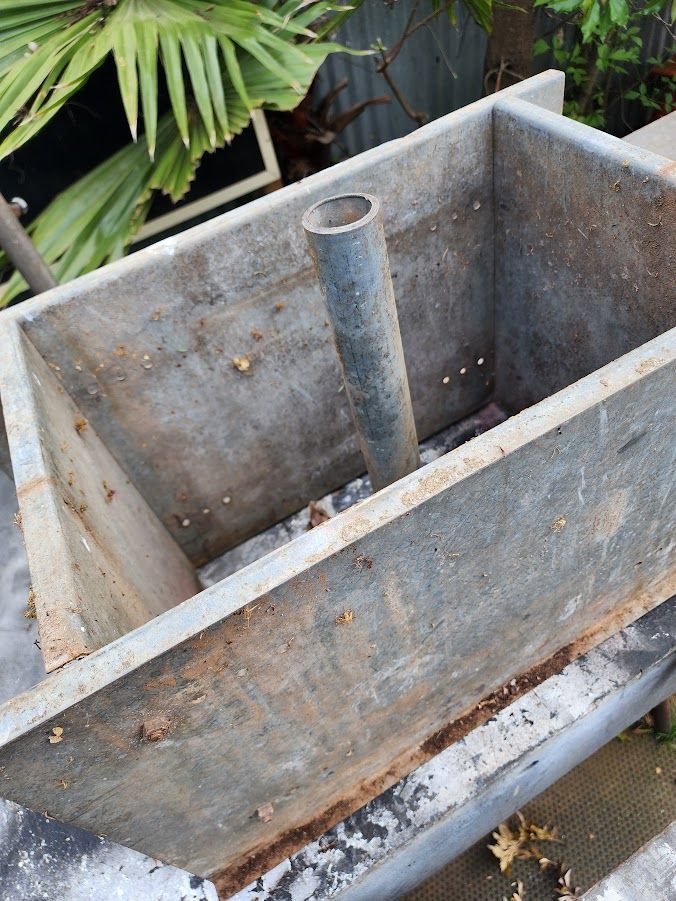

I have a steel version (too dark outside to photo) but dressed timber would work.
Boxed together and an 'insert' (steel pipe or wooden pole) screwed in position.
Concrete poured in.
Before too hard - remove the insert.
Once dry - lift the box off and/or unscrew the frame.

"(too dark outside to photo)"
A new day dawns.
This is one of many 'foundation boxes' my father made up a lifetime ago - sump oil was always coated on the inside.
But the finish would not look good I suspect - for a raised garden.
Good luck!
