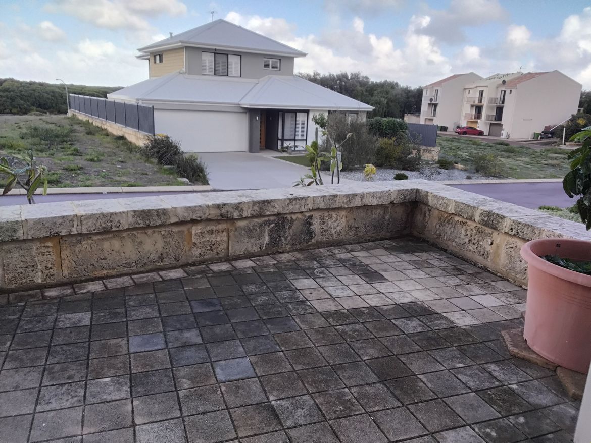

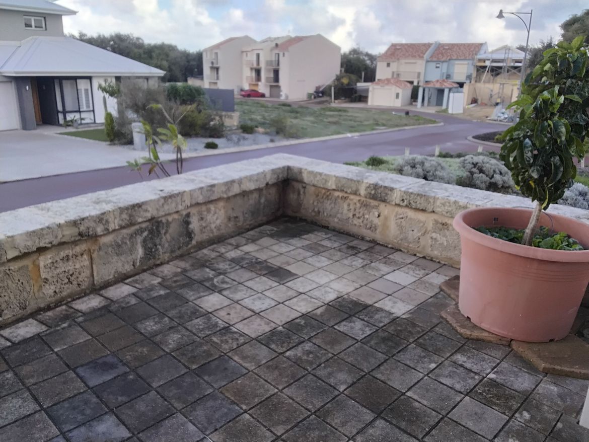

Thanks Jason, here are a couple pics of the area. My plan is to bolt a privacy screen to the top of the wall. It isc600mm high so a 1200mm screen will be perfect. It will be l-shaped and each leg will be 3600mm wide. Hope this is a bit clearer!

Thanks for sharing that photo of your sandstone wall. I suggest looking at using the Jack Screen up privacy screen system. It's relatively easy to install and does not require anything complex to put together. But since you only require it to be 1200mm high the posts will need to be modified on site.
Here is a handy step-by-step guide: Pool Privacy Screen (the techniques used are applicable to your screening project)
Some of the parts are in stock and others will need to be specially ordered, I've listed the parts below, but please check with your store's special orders team for any parts that are not in stock.
Please make sure to choose the one suitable for 19mm Merbau decking panels. The Ekodeck composite panels are too thick and will not work with the Screen Up system.
