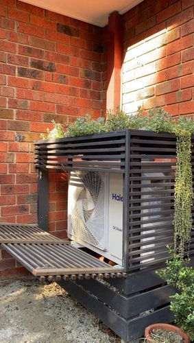

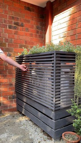

Hi @homeinmelbourne....terrrific looking result. I like the screen (& colour) around the A/C unit so I hope it doesn't cause problems. I want to do something similar for gas bottles...one day ![]()
Cheers, Peter
Thanks @pete_brig! I'm sure the screen idea would be great to cover gas bottles. 👍
We installed magnetic catchers and hinges onto the A/C screen for improved heat exchange when the A/C is in use.
