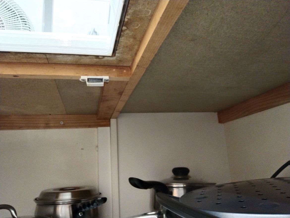

I want a new benchtop for my 40 year old house and have been told that I need to replace my existing sink, which is about 122 cm long and 45 width, with an edge of 4.5 cm, which is too high for most benchtops. I prefer the look of solid timber to laminate but a bit worried about the weight - so undecided there. I've included a photo of the underside of the cabinet.

In your current setup, the sink is already sitting higher than the benchtop, so you’re familiar with how that looks and functions. There’s really no technical reason you’d need to replace the sink purely because of its height. Most modern stainless steel sinks are designed to sit flush or inset within the benchtop, but there’s no issue with retaining your existing one if you’re happy with its appearance and practicality. A new timber benchtop, whether solid rosewood or laminated acacia, can be installed in exactly the same way as your current laminate top, finishing neatly against the sink edge. You’ll still have that slight lip where the sink sits higher, but that’s more of an aesthetic consideration than a functional problem.
If you like how your current sink works and the extra stainless steel protection it provides, there’s no reason to change it. The main thing to ensure is proper sealing between the sink and benchtop to prevent moisture ingress.
Looking at the cabinet, it would be wise to add a bit of reinforcement under the corner where the new benchtop meets, particularly if you go with solid timber, which will be heavier than laminate. That might just mean adding a small support batten or vertical brace. Otherwise, either of your benchtop options should work fine. The rosewood will be heavier, while the laminated acacia panel you linked is lighter and easier to handle, making it a good, affordable alternative.

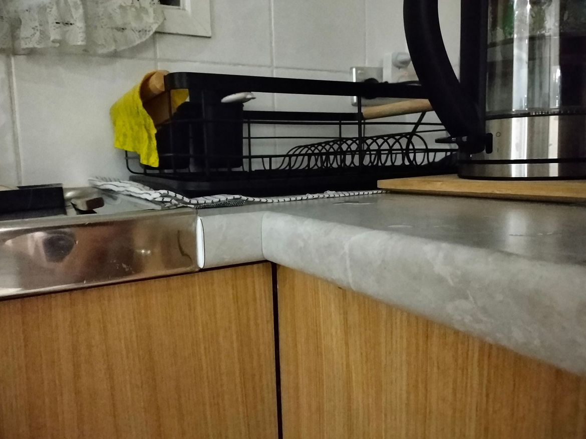

Hello, just updating with photos of my new benchtop, Polytec Portofino stone which I'm very happy with.
I believe the height of the laminate is about 38 mm anyway, so not all that much difference with the sink being 45 mm.
I can't believe I was put off doing this for a year. The installer was the first place I went to for a quote and she said at the time I couldn't have laminate as the height difference would look funny. Other people including my plumber said much the same thing, and suggested a new kaboodle kitchen. This new benchtop cost me $3,800 and I get to keep my big stainless steel sink and no kitchen reno. I'm very happy with the outcome and thank you all for your help.

The new benchtop looks great, and I'm glad to hear the height difference is manageable and you were able to keep your sink.
Thanks for sharing the update.
