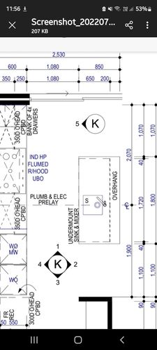

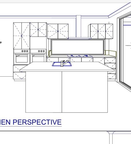

Hey guys. Just trying to find some ideas and hopefully dimensions that preferably won't break the bank on the best option to add some sort of wooden waterfalled edged benchtop that would become an extension over the backside of my current stone island benchtop. I've attached photos above of the idea I'm going for and my current benchtop to hopefully get some advice from anyone reasonably skilled or DIY'rs who've done similar on the how to, how hard and how much I'm potentially looking at to get this done. Appreciate anyones

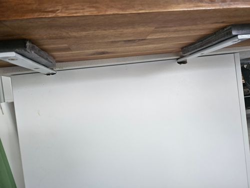

 i could have directly installed supports in front of bench but to hide i just drilled some holes and slided from inside of cabinet.approx 32mm thick wall of cabinet and my extension was not heavy so i though will serve purpose and hide brackets.
