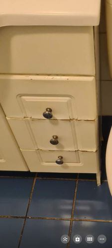

I am preparing for a quick diy renovation project for a property I'm planning to sell. I noticed there was bad chips on the laminate kitchen bench top around the sink. Was wondering what is the easiest way to fix this so it's not so noticeable.
Also I have noticed chips on the surface of cabinet and drawer doors. What's the best way to approach these?

I'm not certain whether any cover-up would provide much benefit as it's clear the bench and the vanity need to be replaced due to water damage. You could try to mask the areas with paint, but I'm unsure how convincing that would look.
What are the chances that the prospective buyer would be doing a renovation and replacing these items anyway?
The vanity, due to the swollen timber, is past the point of repair. Also the benchtop appears to have suffered significant damage, especially at the rear. It would be worth considering whether replacing the vanity and benchtop would benefit your sale price. The vanity can be replaced in a day, and a plumber can hook up the water. The benchtop is a little more complicated, but there are plenty of budget-friendly options to choose from.

Looks like you have the same style of cabinet I do, tho my laminate is ripping away from the top of the drawers.
Like @MitchellMc I dont think it will be easy to bring back/repair the surface. As much as I hate wastage I decided to let it be until I redo the bathroom.
The problem with trying to repair it is once it starts lifting the whole lot wants to lift, Ive considered glue to hold down the laminate and then cut of the stuff that has torn followed by builders bog to fill in the ripple bewteen laminiate and particle board, sand and paint the whole cabinet. Lots of effort and I think the issue would contine with the covering being brittle.
