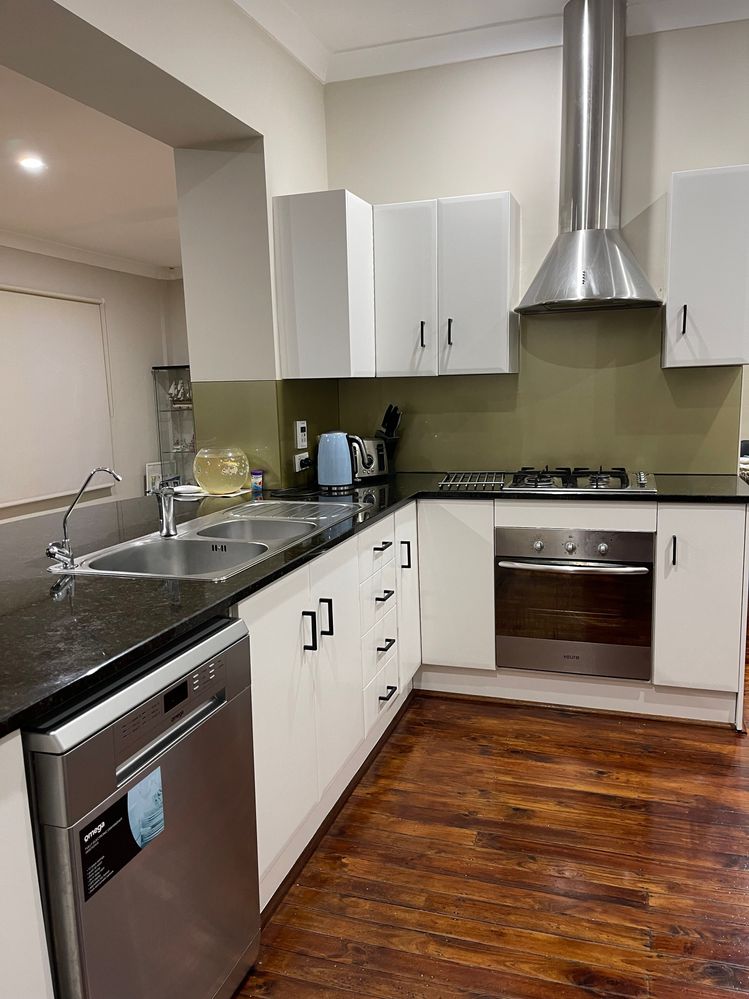

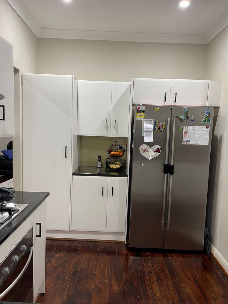

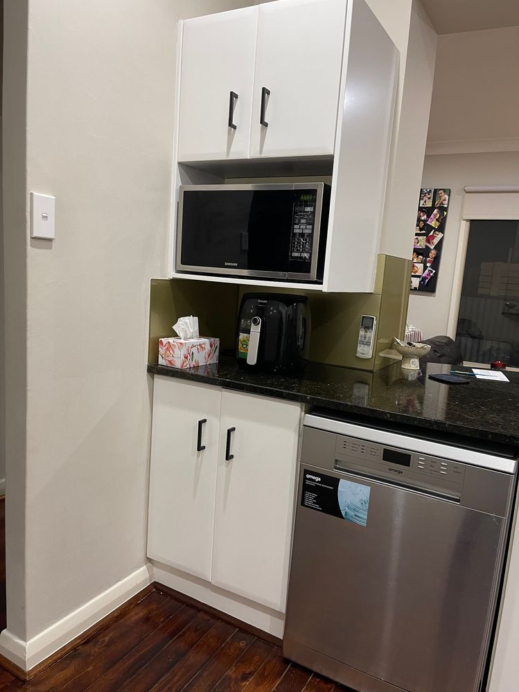

As promised I have going to upload some photos after I painted the MDF kitchen cabinet .
We are very happy with the result .We painted with Natural White .after Paintingafter PaintingIMG_4168.JPGIMG_4171.JPGIMG_4172.JPGIMG_4173.JPGIMG_4174.JPG

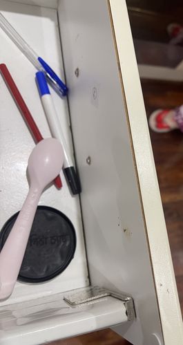

The reason we had to paint is our kitchen cabinet was with Vinyl Wrap and it was coming off so I had to put glue on.
Please see Photos

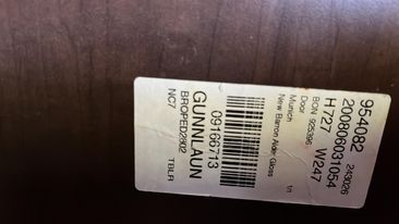

I am wondering if there is a way to pint OVER the horrid high gloss shiny wrap on my cupboards that will look good and last?
348923325_6195283643842587_1599135820653385448_n.jpeg 350356446_1889123751465755_1867264913741868423_n.jpeg
Re: How to Paint vinyl wrap Kitchen Cabinet
Hello @ev_smith
Welcome to the Bunnings Workshop community. It's wonderful to have you join us, and thank you for sharing your question about your vinyl wrapped kitchen.
The Dulux Renovation Range comes with a primer. However, because you have a gloss finish on your vinyl surface, it must be completely removed so that the primer will have a good surface to anchor onto.
I suggest using an Orbital Sander to thoroughly remove the high gloss surface of the vinyl cover. It's critical that the surface be totally prepared as any spot that gets missed will not provide an ideal surface for the primer.
From the photo you posted, it seems that the vinyl cover is still in good condition. However, the choice of removing the vinyl cover is open to you and you can paint the MDF boards just as you've seen in this discussion.
