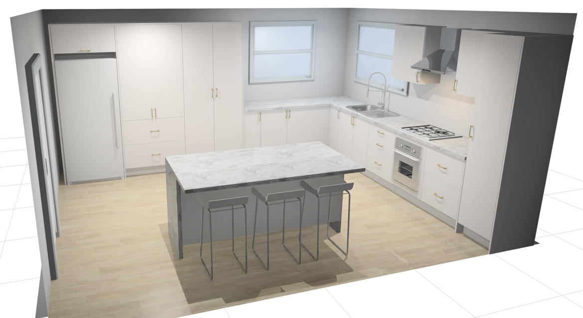

Hi @OverwhelmedReno,
Thanks for your plan. It's also really helpful if you can take several images of the room so we can get a better idea of any obstacles we might need to work with. Just to let you know, we use the Kaboodle planner, and you can use it too if you'd like to play around with the layout. We also offer a sit-down consultation service in-store where a kitchen design expert can plan out your kitchen in real-time with you. This is really helpful as you get to see it come together, and you can make adjustments as necessary. This can also be done online or at your home.
I've spent some time and put a plan together for you. Obviously, without a bit of back-and-fourth it might not be exactly what you are after. Here's one image straight from the Kaboodle planner and another touched up by AI.
