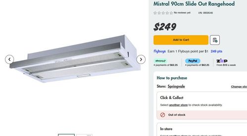

Hi @Robinord,

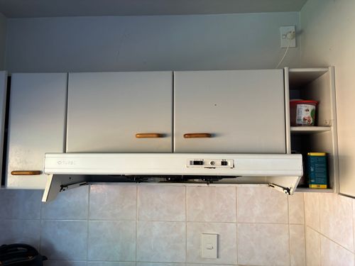

Can we have a photo with the cupboard doors opened so I can verify the one below.
Will be a suitable replacement because I am expecting to see.
A ducting box in there.

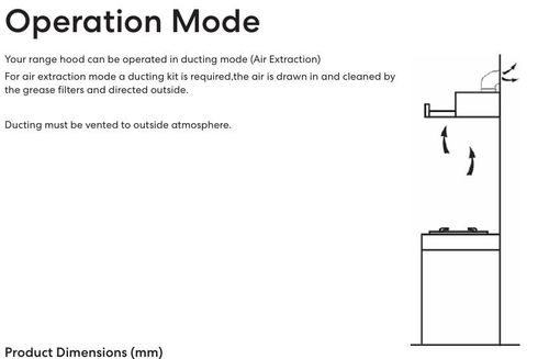

And that is from the User Guide.
